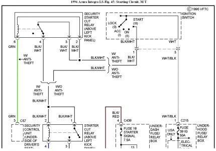

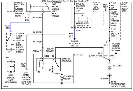

so they car ran fine, up until my friends tried to install a amp for my speakers in my car, the amp kept blowing the fuse so we gave up. I went to start my car and everything came on lights, radio but the car didn't, no sounds no clicking no nothing, so I figured dead battery lights were on doors were open, i'll pop start it drive it home, I got it home ran smoothly the whole way music and all. Got home tried to start it, nothing, check all the fuses all are fine except one changed it still nothing.

Here is a schematic of the starting circuit.
https://www.2carpros.com/forum/automotive_pictures/192750_Starting96IntegraFig45a_1.jpg
https://www.2carpros.com/forum/automotive_pictures/192750_Starting96IntegraFig45b_1.jpg
If vehicle is equipped with security system, check the security cut relay, starter cut relay, ignition switch, clutch interlock switch and starter solenoid wire.
