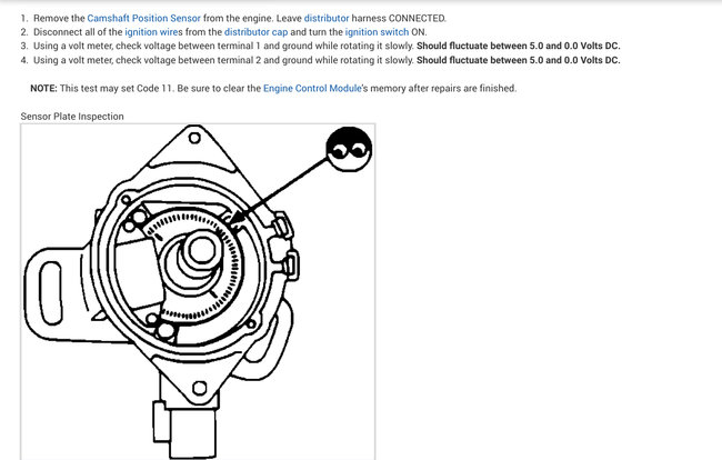

Has great fuel pressure and hot spark to the plugs. Wondering if there is a sensor to allow fuel to the injectors and or possibly a fuse? Have experience with jumped timing belts and it cranks normal not like a sewing machine with no compression. Thank you

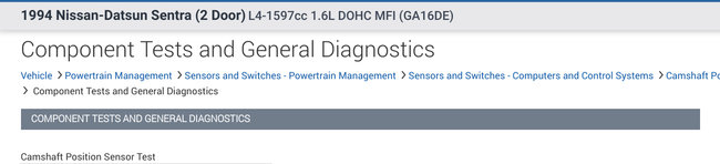

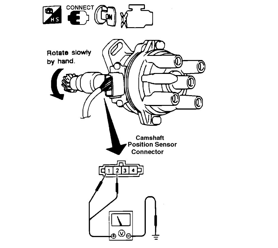

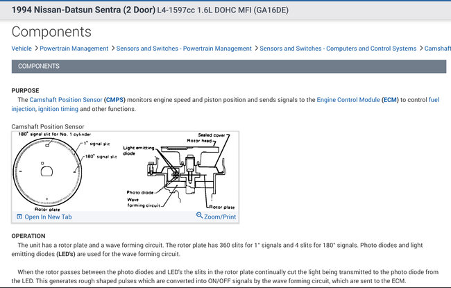

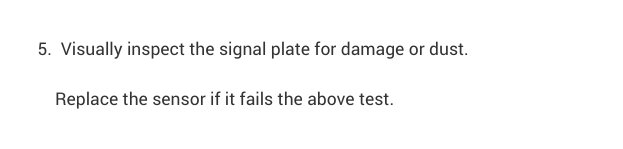

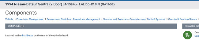

This sounds like it could be a problem with your vehicle's camshaft position sensor[CMP] which is located in the distributor. In the diagrams down below I have included a description of the CMP, it's location, and a guide on how to test the CMP. Please go through these guides and get back to us with what you discover.
