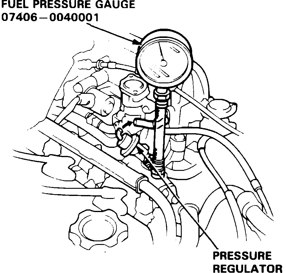

My first suspect is that it is taking too long for fuel pressure to reach the engine. Once the fuel is there, it starts easily. After sitting, it takes time for it to prime again. It could be a plugged filter or the pump itself is allowing fuel to back feed into the tank.
With this issue, the first thing I would do is check fuel pressure. Do this when it is cold and watch the gauge to see if pressure builds right away.

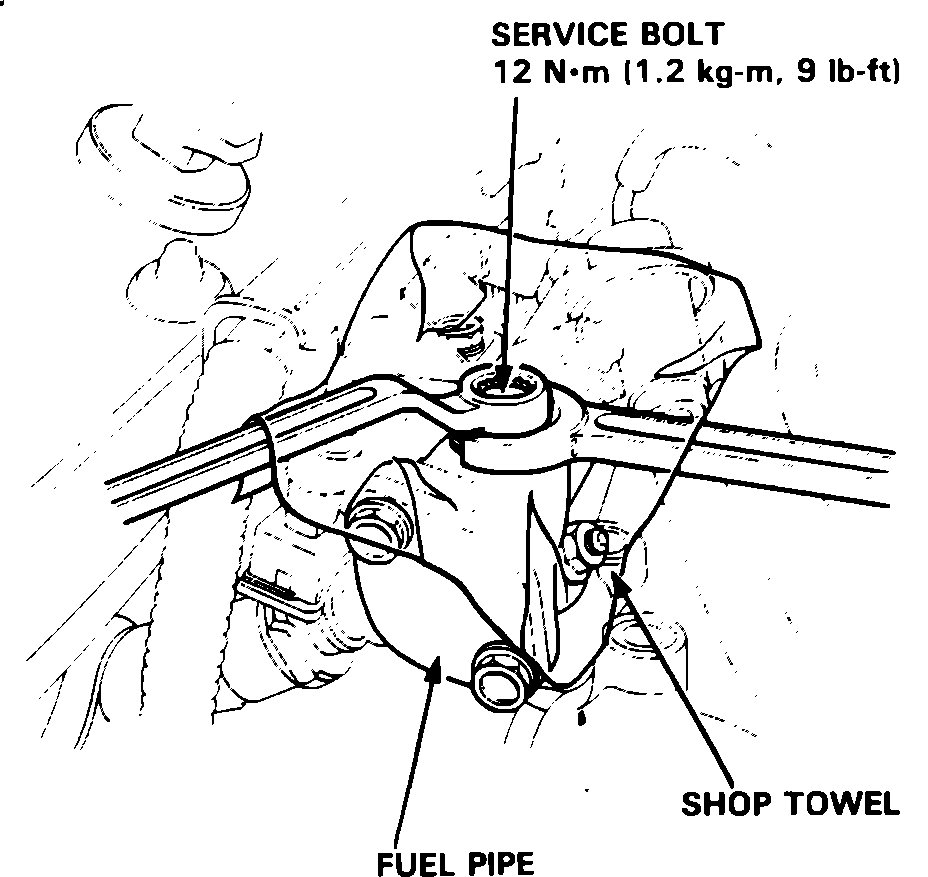

c. Use a box end wrench on the 6mm service bolt at the fuel rail, while holding the special banjo bolt with another wrench.
Fuel System Service Bolt
Pic 1
d. Place a rag or shop towel over the 6mm service bolt.
e. SLOWLY loosen the 6mm service bolt one complete turn.
2. Remove the service bolt on the fuel rail while holding the banjo bolt with another wrench and attach the fuel pressure gauge.
3. Start the engine. Measure the fuel pressure with the engine idling and the vacuum hose of the pressure regulator disconnected.
Fuel Pressure Gauge
pic 2
Unregulated pressure at idle should be:
SE (USA),SE and Ex-R(Canada):
265 - 314 kPa (38-46 PSI)
All other models:
235 - 284 kPa (34-41 PSI)

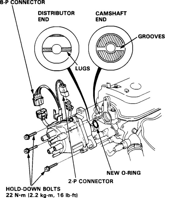

1991 Honda Accord L4-2156cc 2.2L SOHC
Procedures
Vehicle Powertrain Management Sensors and Switches - Powertrain Management Sensors and Switches - Computers and Control Systems Crankshaft Position Sensor Service and Repair Procedures
PROCEDURES

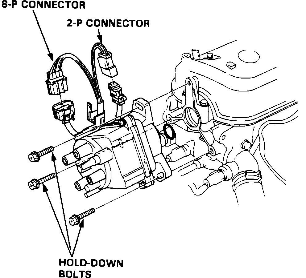

DISTRIBUTOR REMOVAL
1. Disconnect the 2-P and 8-P connectors from the distributor.
2. Disconnect the spark plug wires from the distributor cap.
Distributor Connectors
Pic 1
3. Remove the distributor hold-down bolts, then remove the distributor from the cylinder head.

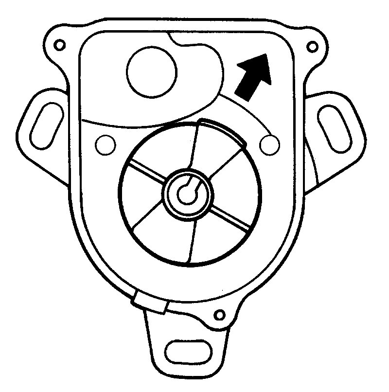

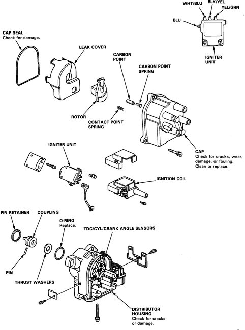

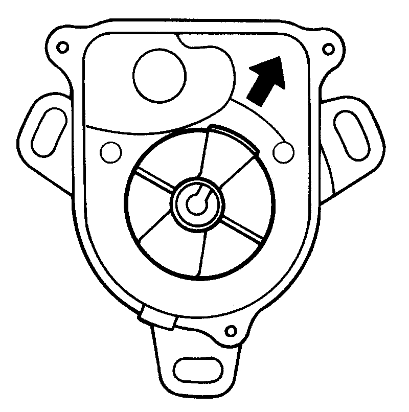

DISASSEMBLY
Distributor Explosion
pic 2
4. Use the exploded view image for distributor disassembly.

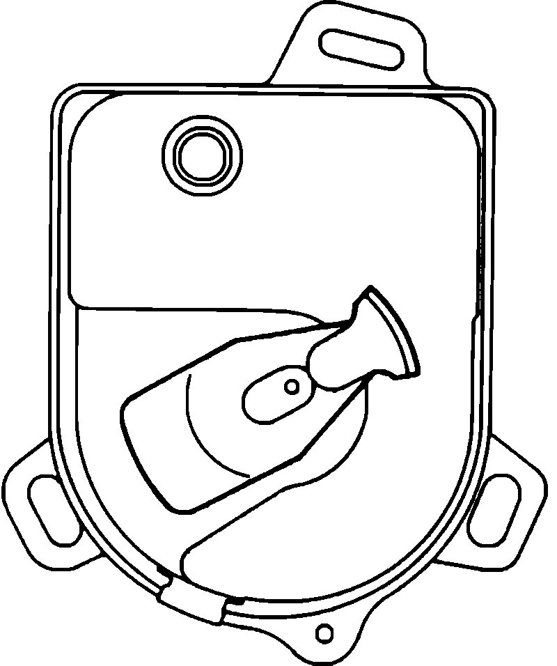

REASSEMBLY
pic 3
Reassemble the distributor in the reverse order of disassembly.

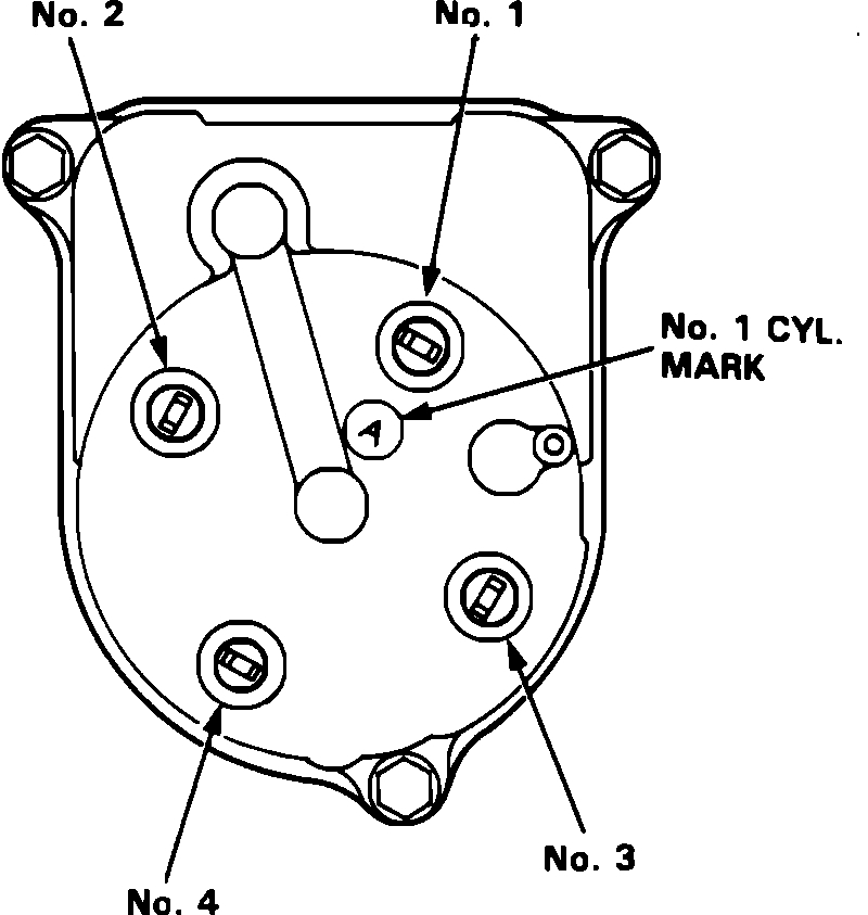

1. Install the rotor, then turn it so that it faces in the direction shown (toward the No.1 cylinder).
2. Set the thrust washer and coupling on the shaft.
Pic 4
3. Check that the rotor is still pointing toward the No.1 cylinder, then align the index mark on the housing with the index mark on the coupling.

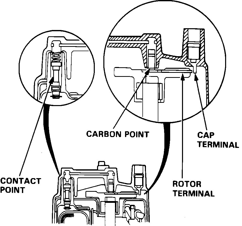

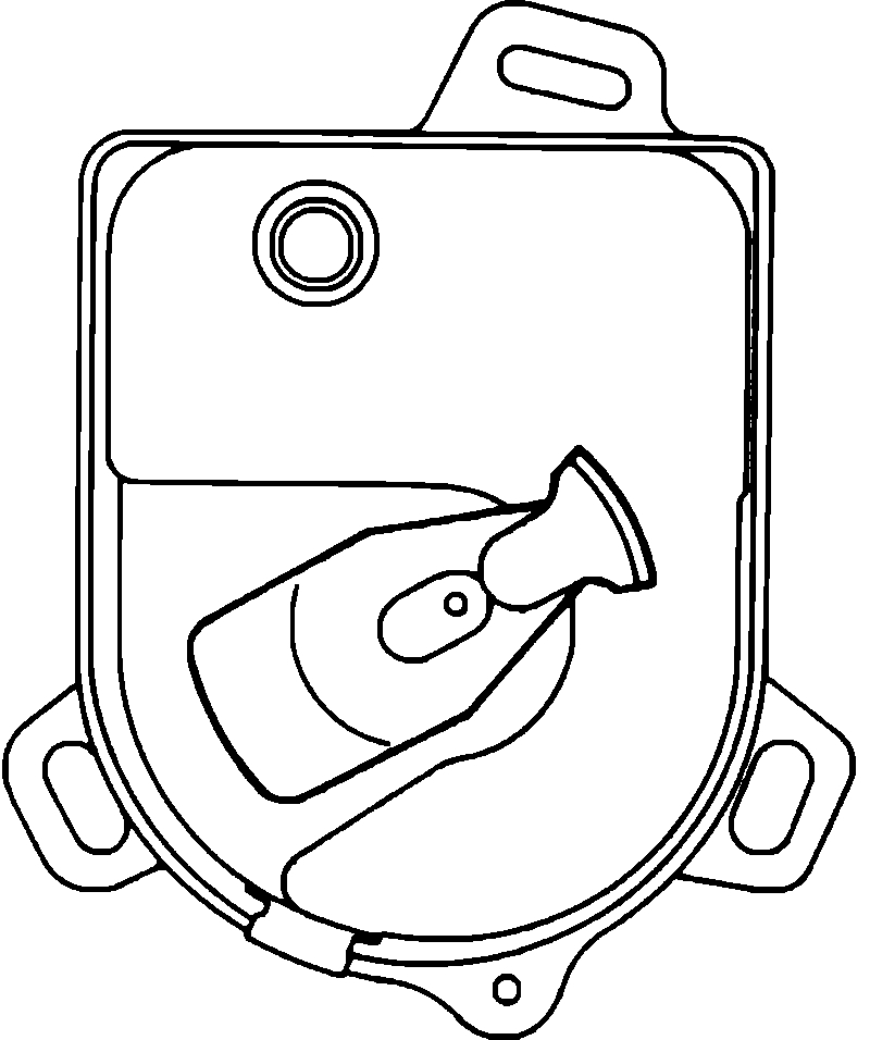

INSPECTION
Cross Section Of Distributor
pic 5
5. Check for rough or pitted rotor and cap terminals.
6. Scrape or file off the carbon deposits. Smooth the rotor terminal with an oil stone or #600 sandpaper if rough.
7. Check the distributor cap for cracks, wear and damages. If necessary, clean or replace it.

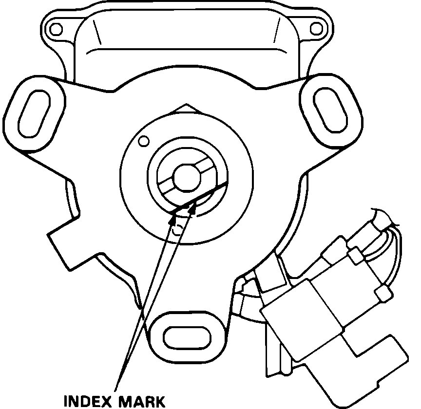

REASSEMBLY
Rotor Position
pic 6

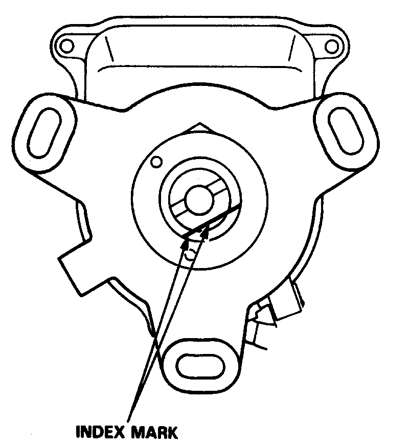

8. Install the rotor, then turn it so that it faces in the direction shown (toward the No. 1 cylinder).
9. Set the thrust washer and coupling on the shaft.

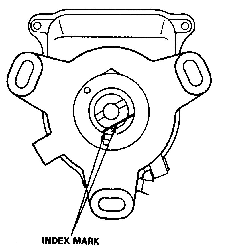

Distributor Index
pic7
10. Check that the rotor is still pointing toward the No. 1 cylinder, then align the index mark on the housing with the index mark on the coupling.
11. Drive in the pin and secure it with the pin retainer.

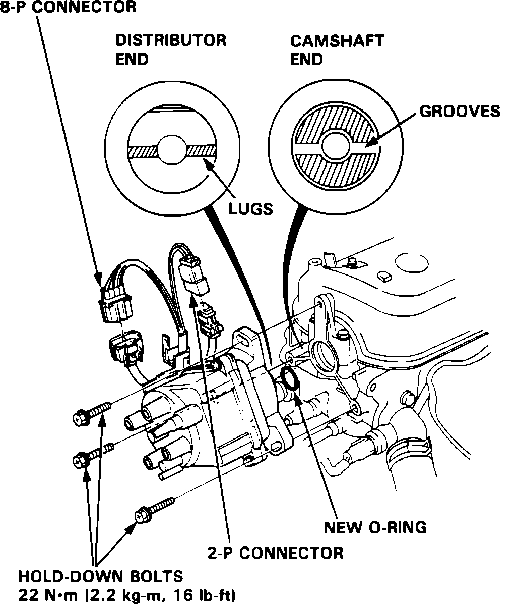

INSTALLATION
12. Coat a new 0-ring with engine oil then install it.
13. Slip the distributor into position.
NOTE: The lugs on the end of the distributor and its mating grooves in the camshaft end are both offset to eliminate the possibility of installing the distributor 180° out of time.
Distributor Installation
pic 8
14. Install the hold-down bolts and tighten temporarily.
15. Connect the 2-P and 8-P connectors to the distributor.
Distributor Cap Typical
pic 9
16. Connect the spark plug wires as shown.
17. Set the timing with a timing light as shown in ADJUSTMENT PROCEDURES.
18. After adjusting, torque the hold-down bolts, then install the cap on the bolt.
Torque: 16 ft. Lbs (22 Nm)
