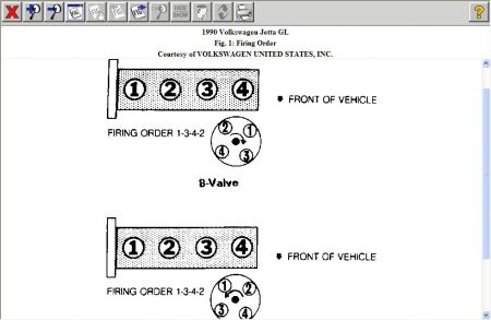

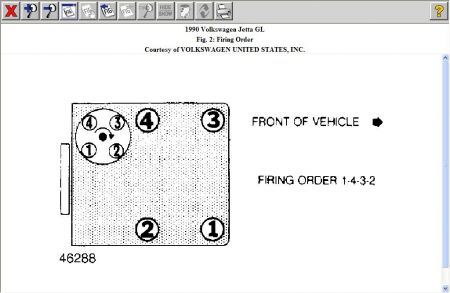

I need the fireing order
Wednesday, July 30th, 2008 AT 11:50 PM
MECHANIC
75,992 POSTS
There you go pick your engine and have a nice day
