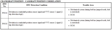

I get these two codes P0016 and P0018. What is the solution?

Most likley cause is a the timing belt has jumped a tooth, or strethech and the crank and cam are not in time anymore. New timing belt is needed!
