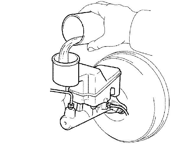

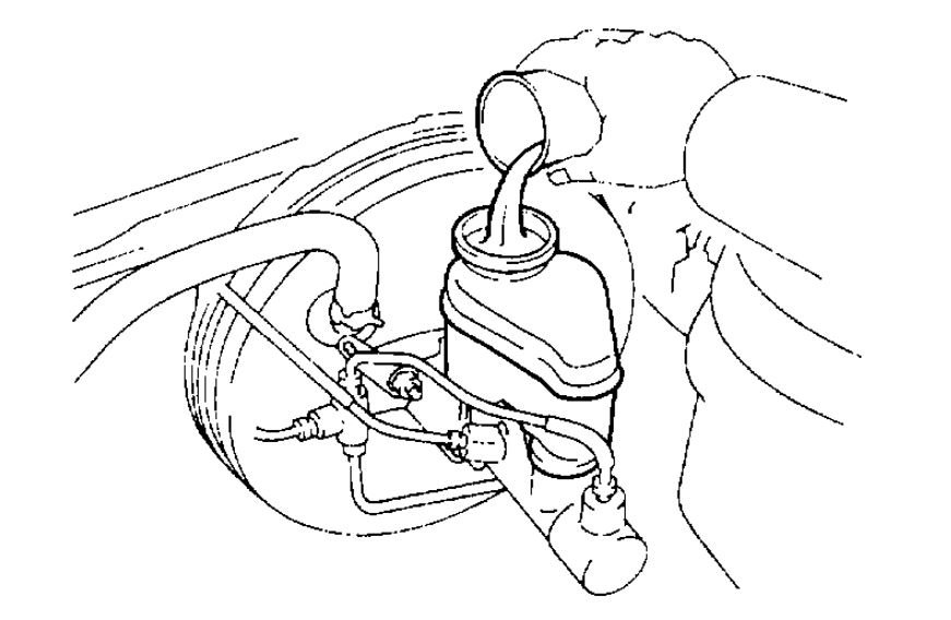

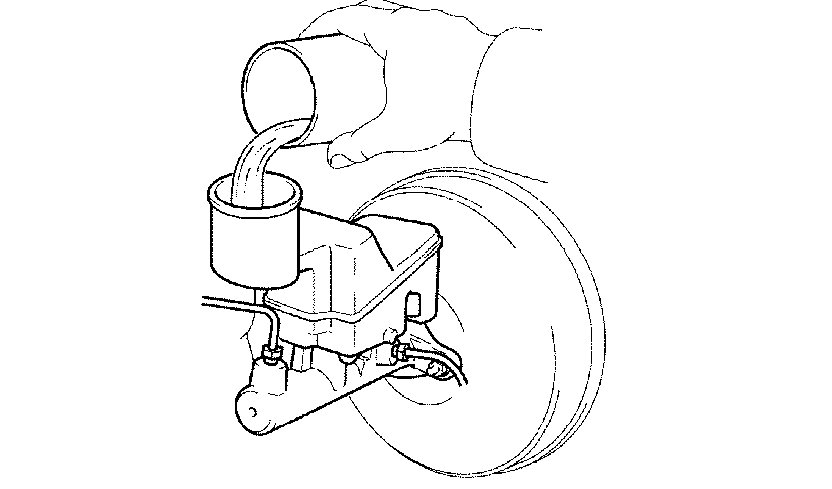

1. FILL RESERVOIR WITH BRAKE FLUID
(a) Fill reservoir with brake fluid.
Fluid: SAE J1703 or FMVSS No. 116 DOT3

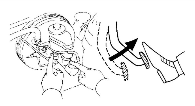

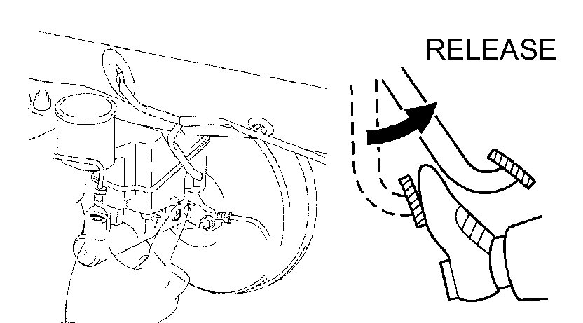

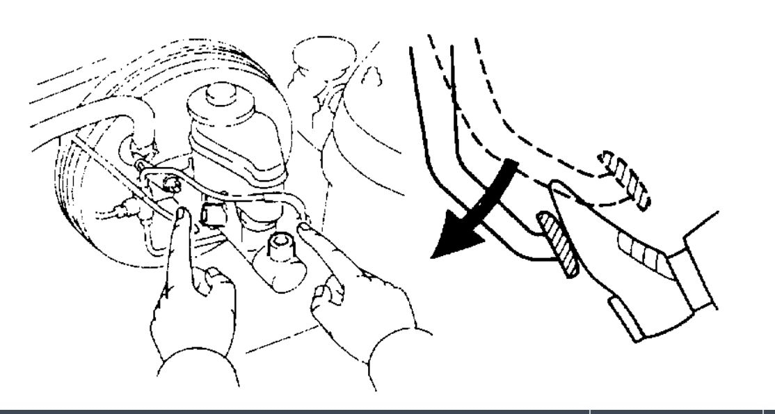

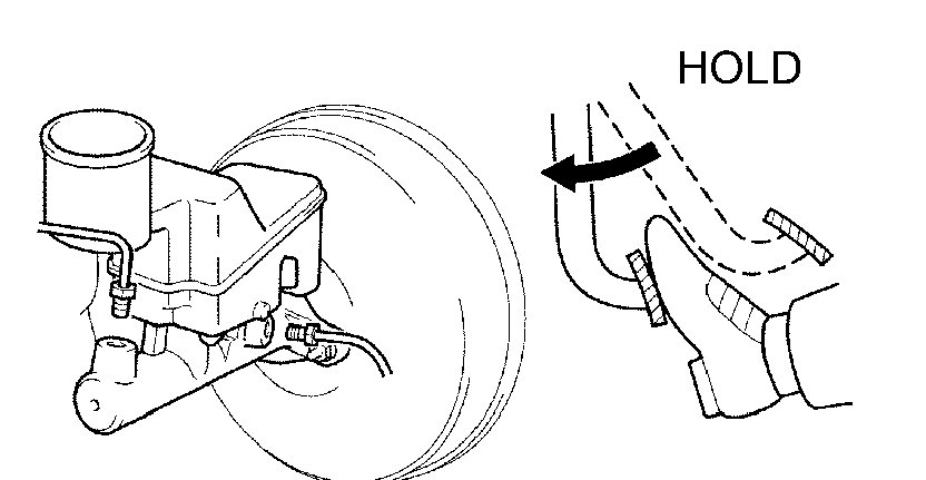

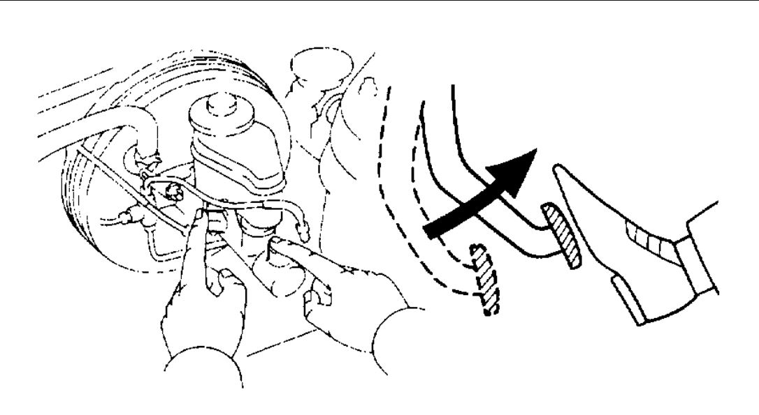

2. BLEED MASTER CYLINDER
HINT: If the master cylinder has been disassembled or if the reservoir becomes empty, bleed the air out of the master cylinder.
(a) Using SST, disconnect the brake lines from the master cylinder sub-assembly.
SST 09023-00101
(b) Procedure A
(1) Slowly depress and hold the brake pedal.
(2) Cover the outer holes with your fingers, and release the brake pedal.
(c) Repeat procedure A 3 or 4 times.
(d) Using SST, connect the brake lines to the master cylinder sub-assembly.
SST 09023-00101
Torque: 15 Nm (155 kgf-cm, 11 ft. lbs.)

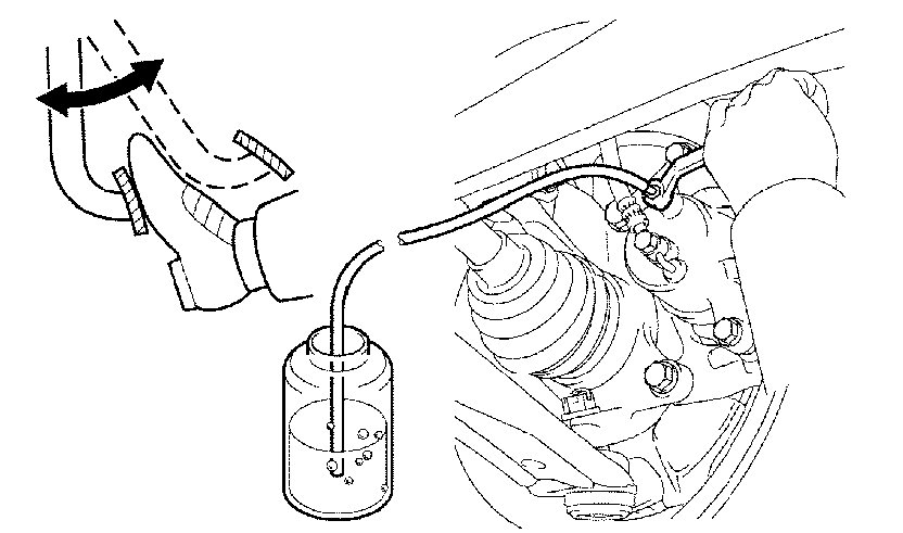

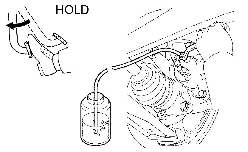

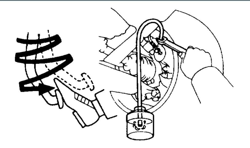

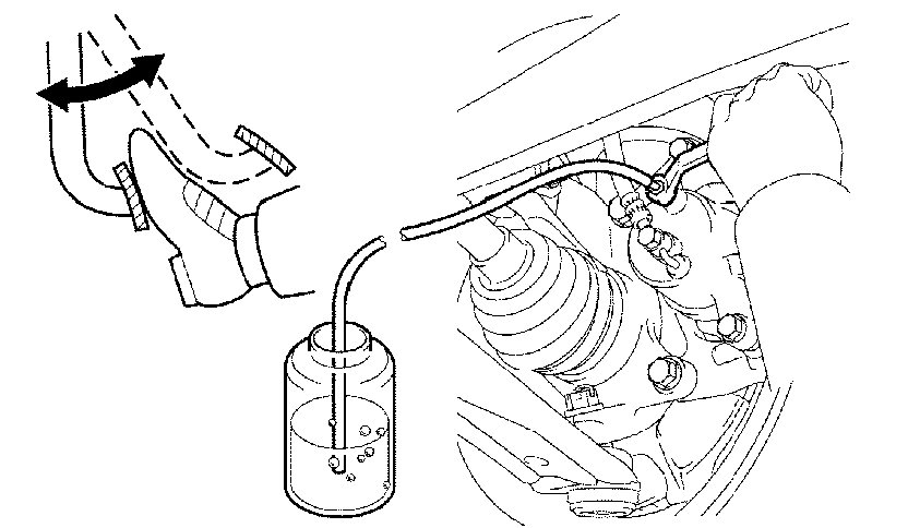

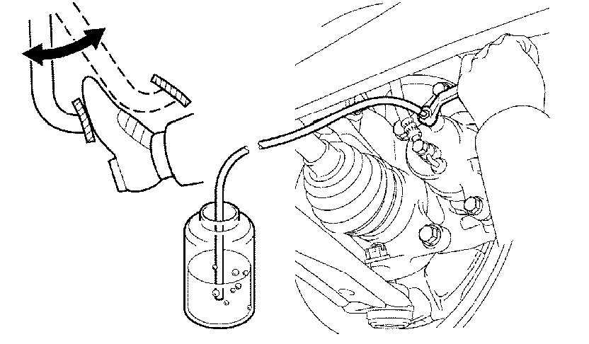

3. BLEED BRAKE LINE

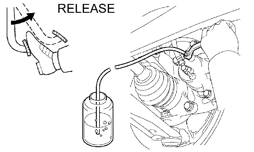

(a) Connect the vinyl tube to the bleeder plug.

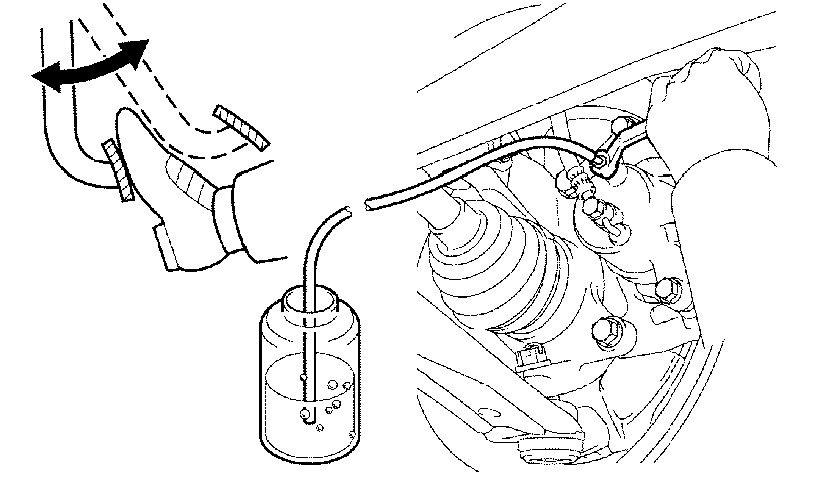

(b) Procedure B
(1) Depress the brake pedal several times, then loosen the bleeder plug with the pedal depressed.
(2) When fluid stops coming out, tighten the bleeder plug, then release the brake pedal.
(c) Repeat procedure B until all the air in the fluid is completely bled out.
(d) Tighten the bleeder plug completely.
Torque:
Front brake 8.3 Nm (85 kgf-cm, 74 inch lbs.)
Rear brake 8.3 Nm (85 kgf-cm, 74 inch lbs.)
(e) Repeat the above procedures for each wheel to bleed the air out of the brake line.

Check out the diagrams (Below). Let us know what happens and please upload pictures or videos of the problem.

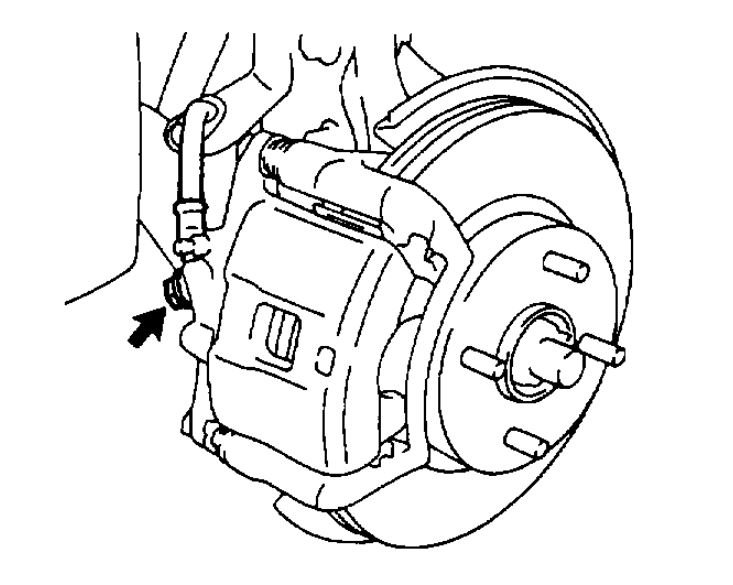

1) Can you explain in detail as to the location of the Brake Fluid Bleeder screws? From my understanding these need to be loosened to do a proper flush. Do I need to remove the wheel to have access to them? Again, this is for a 2003 Toyota Corolla.

Remove the wheel, the bleeder screws are on the inside on top of the caliper. Use a tubing wrench or 6pt. Socket to loosen. Attach a clear hose to bleeder screw and put in a bottle of clear brake fluid. Gently pump brakes until fluid runs clear and make sure the resivour does not run dry. Tighten bleeder screw.
