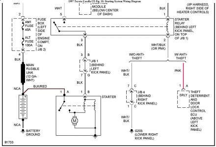

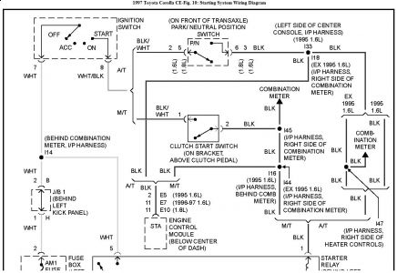

I live in louisiana and it isjustnow getting cold. My car will not start in the cold weather. The ignition will turn over but it makes no sound then when it warms up it starts right up? Please help!Asap

I have checked the battery, clean the posts, the battery is fine, the starter has been knocked, the lights all come on when the ignition key is turned but it makes no sound. Not even a click. The dash lights come on but no sound when you turn the key.

Here is a wiring schematic with a description of the component location. Check the starter relay, try swapping it with any other that is similar, to test.
http://www.2carpros.com/forum/automotive_pictures/192750_StartingCircuit97CorollaFig10a_1.jpg
http://www.2carpros.com/forum/automotive_pictures/192750_StartingCircuit97CorollaFig10b_1.jpg
