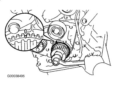

Timing belt marks not visible what can be done to set the timing properly

Hi there,
Set the engine to TDC No1, there is a notch on the crank shaft pulley and a timing mark on the engine, check this alignment and on the cam, there is a small hole in the gear which aligns with a mark on the backing plate, I will post a pic when I get access to Mitchell 1.

Timing alignment pics,
Mark (mhpautos)
https://www.2carpros.com/forum/automotive_pictures/61395_1_74.jpg
https://www.2carpros.com/forum/automotive_pictures/61395_2_15.jpg
