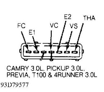

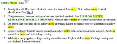

Hi there,
Air flow meter tests.
https://www.2carpros.com/forum/automotive_pictures/61395_Noname_50.jpg
https://www.2carpros.com/forum/automotive_pictures/61395_Noname1_9.jpg
https://www.2carpros.com/forum/automotive_pictures/61395_Noname2_5.jpg
Mark (mhpautos)
