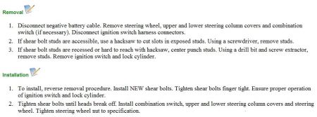

I don't understand how to remove the ignition switch if you could help me I would appreciate it.

You replacing the actual switch or just the lock cylinder where key inserts?

Just the switch the key goes into. Any help would be great.

BLUELIGHTNIN6
MECHANIC
16,542 POSTS
Monday, September 6th, 2010 AT 7:56 PM
