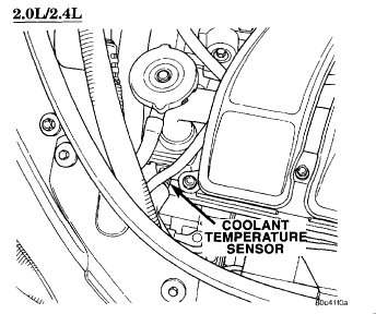

If the pressure is good, I would next check the coolant temp sensor, CTS. There are two coolant sensors. One is for the gauge in the vehicle and the other tells the computer the coolant temperature. The computer takes the temperature readings and then determines how rich or lean to make the fuel mixture. If it is too lean or too rich, it will cause a misfire which could lead to the other issues. The easiest way to check one is with a live time scanner. You can simply look at live data to determine what temperature the computer is receiving.
If you determine the sensor is the problem, it will need replaced. I have attached a picture of its location.
I hope this helps. Please keep in mind, without knowing specific codes, it is difficult.
