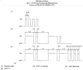

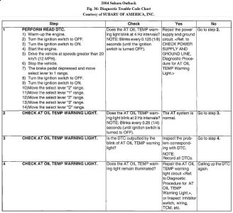

Try the following to see if you can retrieve any trouble codes. I am not sure if the A/T or Sports mode light would blink if it works.
READ DIAGNOSTIC TROUBLE CODE (DTC)
OPERATION
https://www.2carpros.com/forum/automotive_pictures/192750_DTCchart04OutbackFig36_1.jpg
"Â The way of reading DTC
The AT OIL TEMP warning light flashes the code corresponding to faulty part.
The long segment (1.2 sec on) indicates a "ten", and the short segment (0.2 sec on) signifies a "one".
https://www.2carpros.com/forum/automotive_pictures/192750_DTCBlink04OutbackFig37_1.jpg
