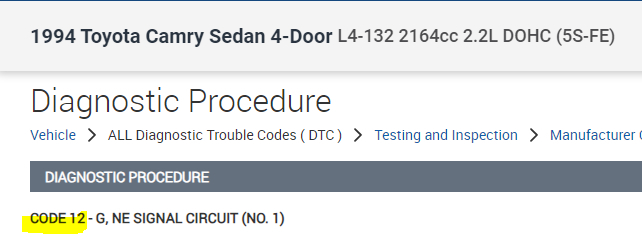

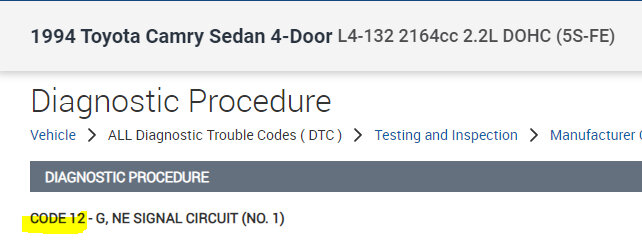

We tested it and got Code 12: Engine revolution signal missing.

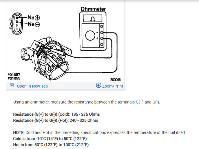

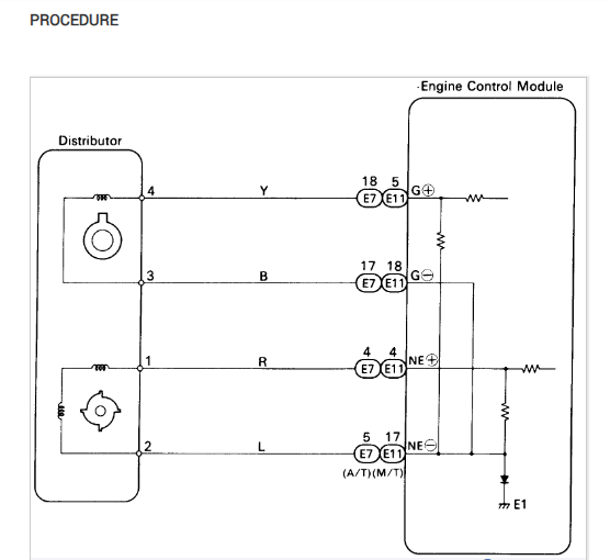

In the distributor there is a pick-up coil. Based on the code, that is where the issue is coming from. It doesn't necessarily mean the pick-up coil is faulty, but chances are that is the issue.
I attached diagnostics below. Take a look through them and let me know if you are comfortable performing them.

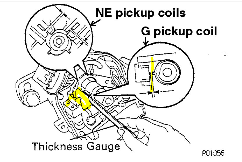

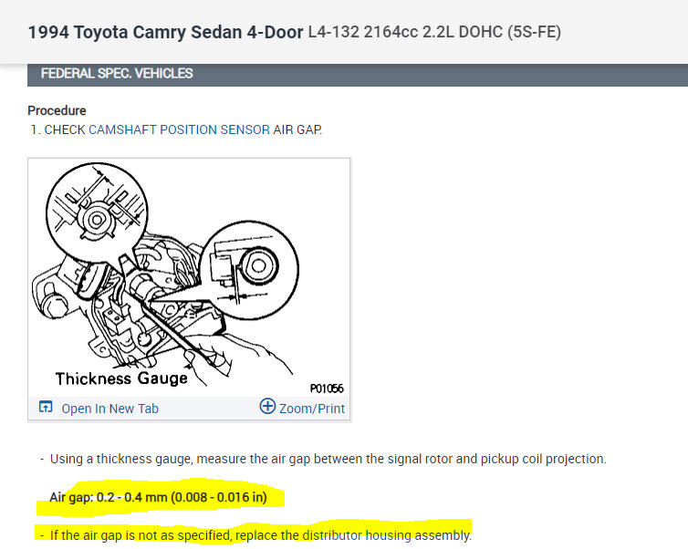

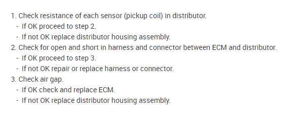

Thanks Joe. Can you tell me where the sensors are located, or how to access them? Also, what is the “air gap” for test 3? If I can find them, I’m willing to try the tests.
Monday, March 25th, 2024 AT 9:14 PM
  • 108,407 POSTS
The pick-up coil is located in the distributor. If you look at pic 1 below, I highlighted the pick-up coil and then I have a straight line where you are checking airgap.
The remaining directions are for testing purposes. They provide the manufacturer's air gap specifications and also indicate how to test the resistance in the pick-up coil.
Note: The manual refers to the same part as a camshaft position sensor in one section and the pick-up coil in another. They are one in the same.
Let me know if this helps.

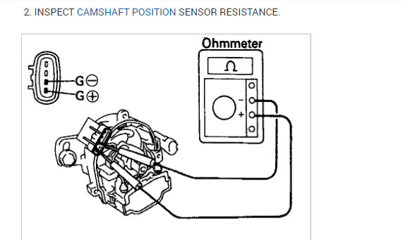

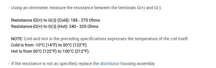

We measured the coil; the first test the bottom pins, zeroed out and beeped for continuity. The top pins measured 535 ohms.
Wednesday, April 10th, 2024 AT 5:48 PM
  • 108,407 POSTS
That appears to be well out of spec. Is it new as well as the other parts? Have you tried replacing it? If not, I suspect that would be a good place to start. I have a feeling that is causing the idle issue.

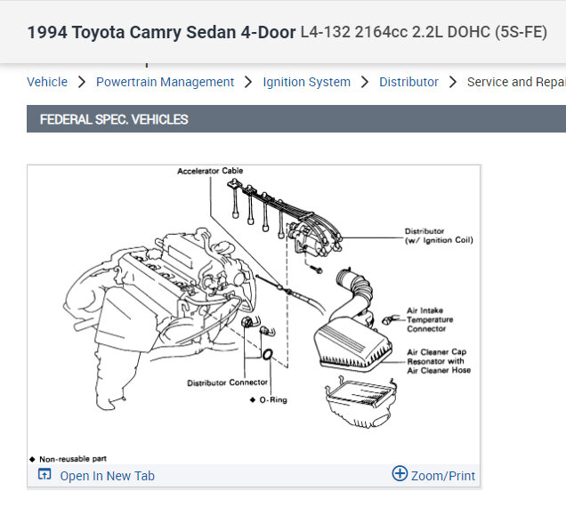

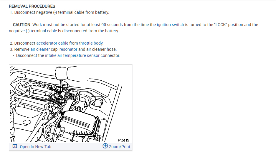

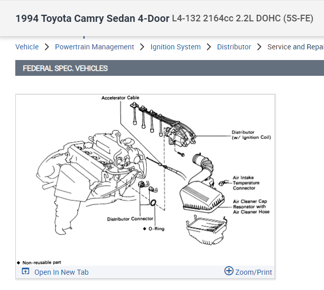

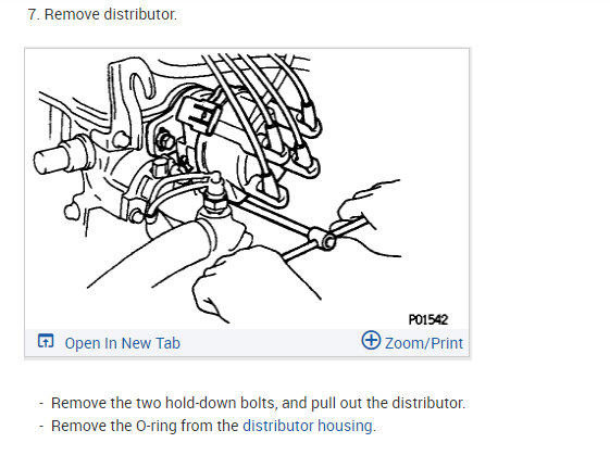

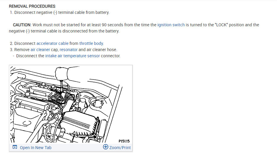

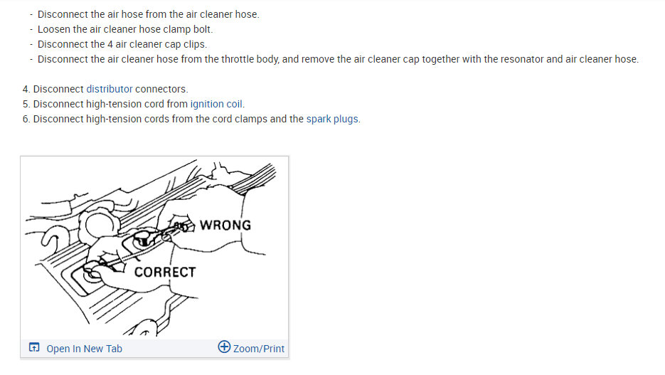

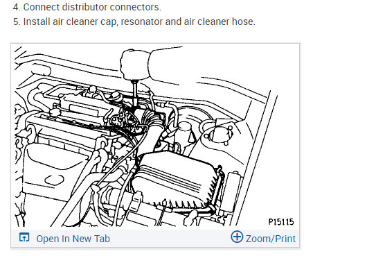

It looks like that sensor is built into the distributor and the whole distributor would need to be replaced, can you confirm that?
Wednesday, April 10th, 2024 AT 9:24 PM
  • 108,407 POSTS

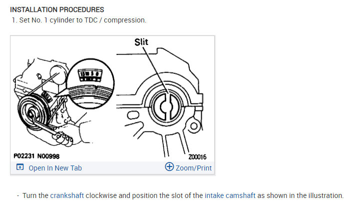

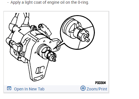

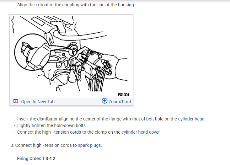

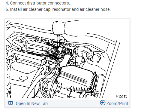

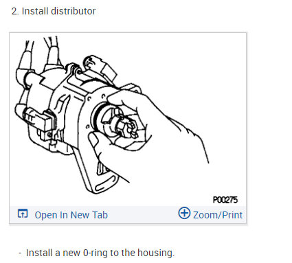

Looking at an exploded view of the distributor, it looks like you are correct. It appears to be integral.
I don't know if you need them, but I attached the directions below for replacing the distributor. Take a look through them and let me know if you have questions.
