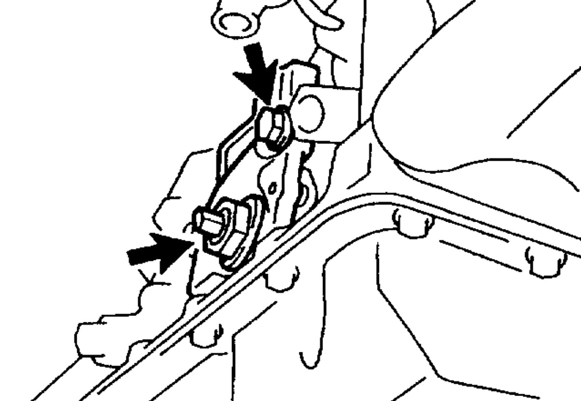

Leaking from the selector shaft seal, any help in going about it? Thanks in advance.

The book shows replacing them as part of an overhaul, however they are both installed from the exterior of the case. As such it should be possible to replace them without tearing the transmission apart. I would suggest doing it as part of a service, so you don't take a shower in transmission fluid. Drain the fluid and drop the pan.

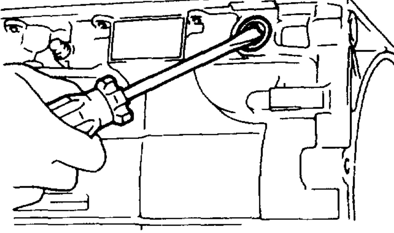

Now to change the seal you unbolt the lever from the side. Then use some brake cleaner to clean off all the crud from around the seal. Then use a screw to pull the old seal out like these videos:
https://www.youtube.com/watch?v=iQwulUnPxew
https://www.youtube.com/watch?v=Ehqz1Y-ggGo
Then use a piece of tubing or pipe to install the new seal.

The shaft goes through the transmission, so it has a seal on both sides of the transmission. However, if it's only leaking on the lever side you don't need to do both. They only list a full overhaul kit not the individual seals.
