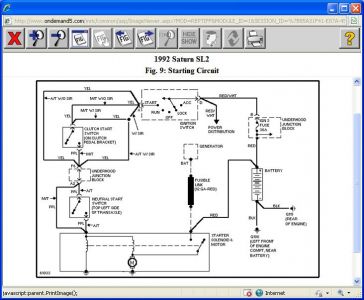

Hey again I have a few hours to work on my car tonight so I wanted to ask you where the leectrical part of the starter is located and for a discription of it
Tuesday, June 1st, 2010 AT 11:35 AM
SATURNTECH9
  • 30,869 POSTS
https://www.2carpros.com/forum/automotive_pictures/416332_1992_sl2_starting_wire_diagram_1.jpg
You never said if your engine turn over freely by hand with the spark plugs out?First check your ignition 3 fuse in your under hood fuse box make sure it's not bad..The easy way to check the starter circuit is go to your selector switch mounted below your brake master cylinder it has your shifter cable going to it.There will be two big purple wires coming off it that are side by side have someone turn the key to the start postion and hold it there you should have battery voltage to both those wires while the connector is plugged in.Let me know what you find Like if you only have power to one wire or full battery voltage to one and partial to the other.
