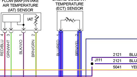

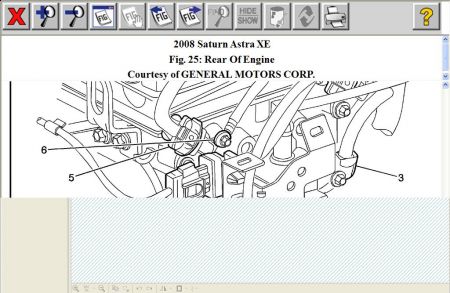

Hi grabby and TY for the donation
The engine coolant temperature sensor is on rear of engine on coolant outlet see no.3
https://www.2carpros.com/forum/automotive_pictures/12900_ect_location_1.jpg
The engine coolant tempearture sensor has 2-wires a blue and red and the other is brown and yellow.
1. blue and red is the ECT sensor
2. brown and yellow is the low reference
https://www.2carpros.com/forum/automotive_pictures/12900_ect_sensor_saturn_1.jpg

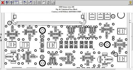

Get a jumper wire long enough to reach from the fan motor connector to the underhood fuse block.
Connect one end to the red and yellow wire at the fan motor and the other end to the underhood fuse block relay K1 terminal 87 clip it together with the relay-see below Did the fan come on? key at run position
https://www.2carpros.com/forum/automotive_pictures/12900_k1_1.jpg
Underhood fuse block
https://www.2carpros.com/forum/automotive_pictures/12900_k1_3.jpg
-1
Wednesday, October 28th, 2009 AT 4:24 AM
GRABBY
  • 8 POSTS
Hi it worked the fan turned on but there are two fans on the astra one behind the radiator (on the left)and one in front on the ac condenser (on the right) do I have to do that to the one in front of the ac condenser to, I turned on the one behind the radiator using k2?Or is that fan just for the ac?Also I am a bit worried having the fan allways on on, there is no tempeture gauge, its just a light that turns on when the engine is over heating but if the sensor is unpluged can the engine still overheat?Also is there any way to make that sensor work again beacuse I just cant find it ive looked everywhere?Thanks a bunch
