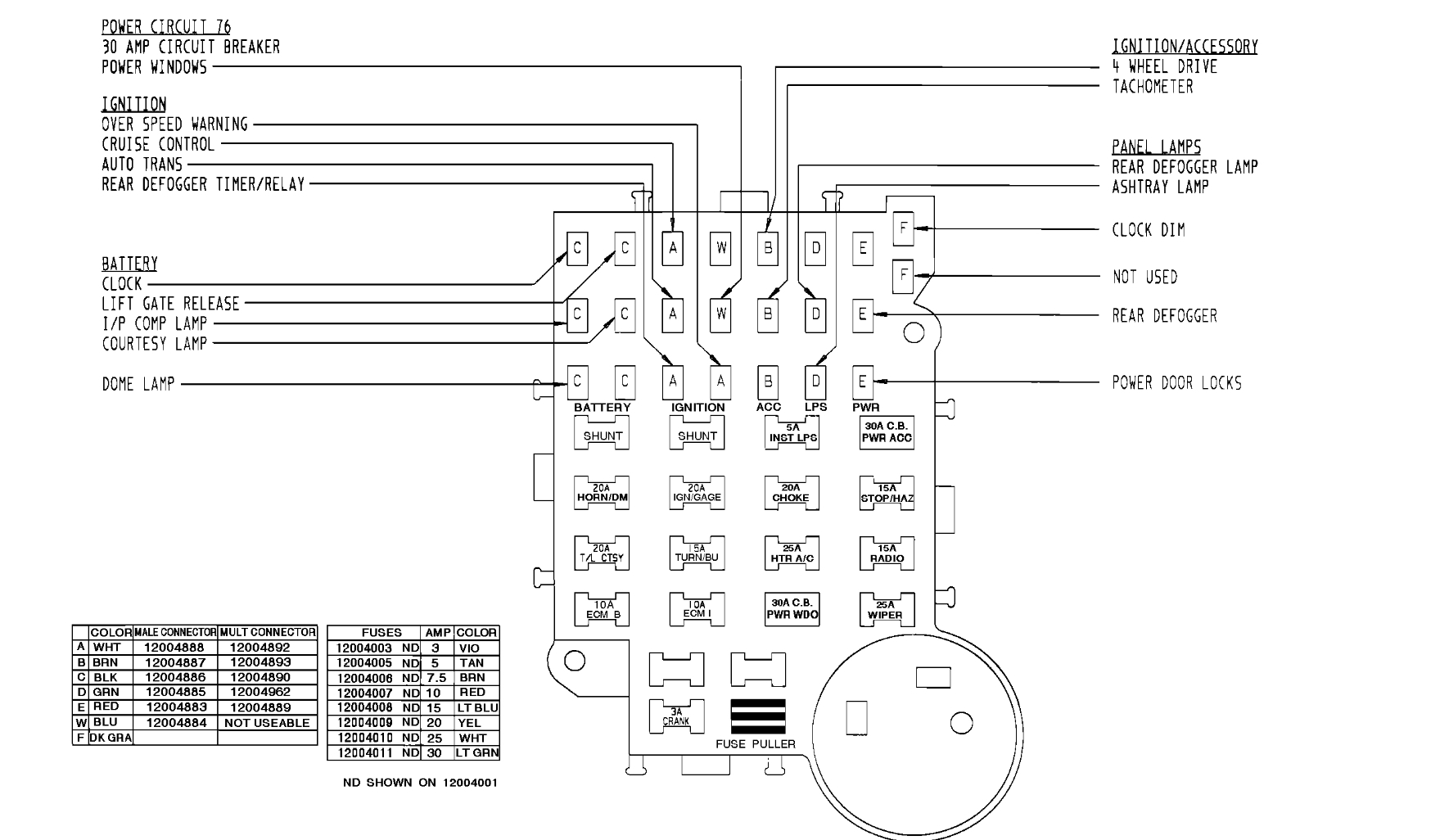

Drove my truck to the store left the lights on when I came back out the battery was dead. So I took the battery home and charged it. When I went back to install the battery I went to hook up the positive cable and it sparked and now truck turns over but will not start! Somebody got under the fuel tank when I crank it and said it must not be getting power to fuel pump, but I am not sure where I should start. I did check the fuses under the drivers side dash and all were corroded so I cleaned them up but nothing. Any ideas? Maybe one of the three relays located behind the power booster? Please help

JOETECHPRO
  • 705 POSTS
Hey LEON ALLEN,
I have attached the fuse locations below. You are looking for the ECM B fuse at the bottom left.
This may be the interior fuse box you were checking before I cannot find the location. Check the diagram against what you have there.
If blown replace the fuse, you may have another issue causing the fuse to blow so monitor the vehicle after replacement.
If this is the problem let us know and we can run you through what might be causing it.
Hope this helps.
Regards, Joe
