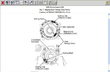

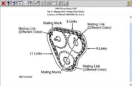

I WANT TO KNOW ABOUT HOW TO DO THE TIMMING CHAIN SETTING
Thursday, September 11th, 2008 AT 5:14 PM
MECHANIC
75,992 POSTS
Put engine no. 1 piston on its compression stroke/TDC then do below
