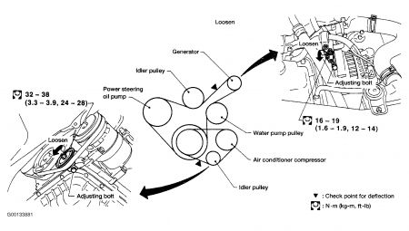

Looks like it is right on top. Shouldnt be too dificult.Disconnect neg batt cable before starting any work. Unbolt pivot and mounting bolts and remove alt, install new one.Be sure battery is charged before starting car or you could damage new alt.I included a pic of the belt routing in case it falls off the pulleys

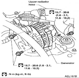

Hi frankpier,Welcome to 2carpros and TY for the donation.
https://www.2carpros.com/forum/automotive_pictures/12900_a_3.jpg
REMOVAL
1.Remove upper radiator hose.
2.Disconnect harness connectors, harness stay and harness to A/C compressor.
3.Release accelerator wire.
4.Back off adjustment bolt, remove belt.
5.Remove three generator bolts and generator.
INSTALLATION
To install, reverse the removal procedure.
