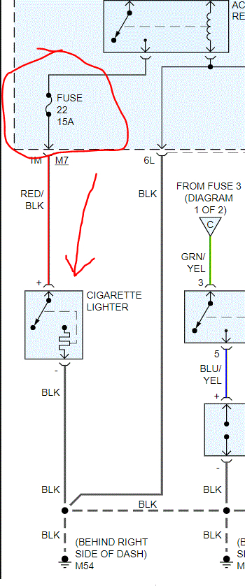

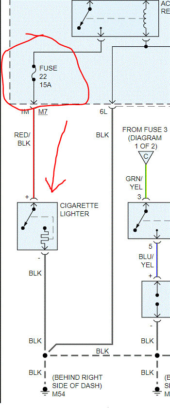

Sorry, I meant to say that I changed the alternator not radiator, lol. The fuse that keeps on blowing is in the fuse box located on the driver's side when you pop the coin case. Its position 22 and it's a 10amp fuse. I tried finding a fuse diagram for my car listed above (1.8s) to make sure the order was correct and if it was the correct number fuse but I couldn't find it anywhere. So if the car isn't getting fuel would that be due to a bad fuel pump or relay? Also what would cause the cluster, radio and headlights not to work or show anything, but my horn works.
Tuesday, October 20th, 2020 AT 7:03 PM
  • 108,560 POSTS
Fuse 22 is a 15 amp fuse for the cigarette lighter. See pic 1.
If that keeps blowing, check to make sure a coin didn't drop down inside where the lighter would go.

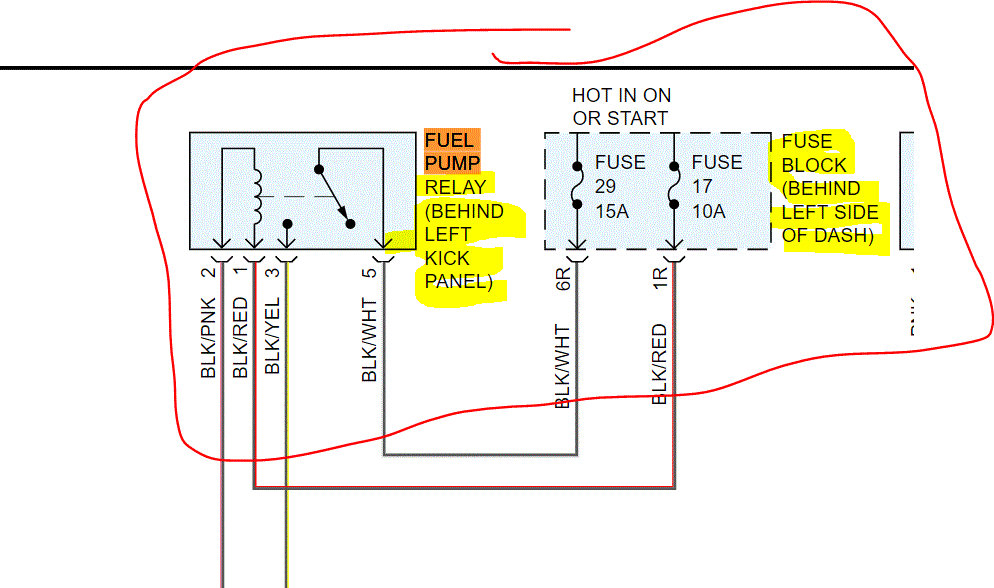

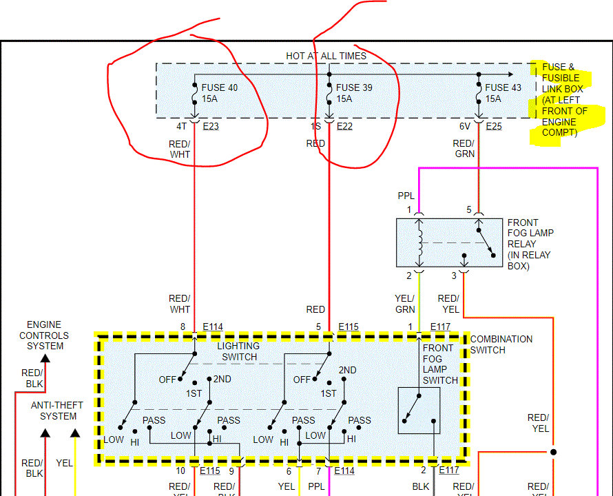

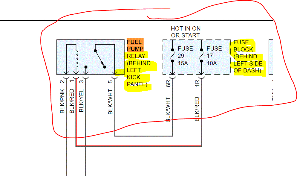

Let's start with the headlights. Look at pic 2. I circled two fuses I need you to check. When checking, also check if there is power to the fuse as well as power out from it.
As far as the fuel pump, it could be bad or it may not be getting power. I need you to check fuses 17 and 29 in the fuse box behind the dash, left side. See the pic from above. Also, make sure they are getting power both in and out.

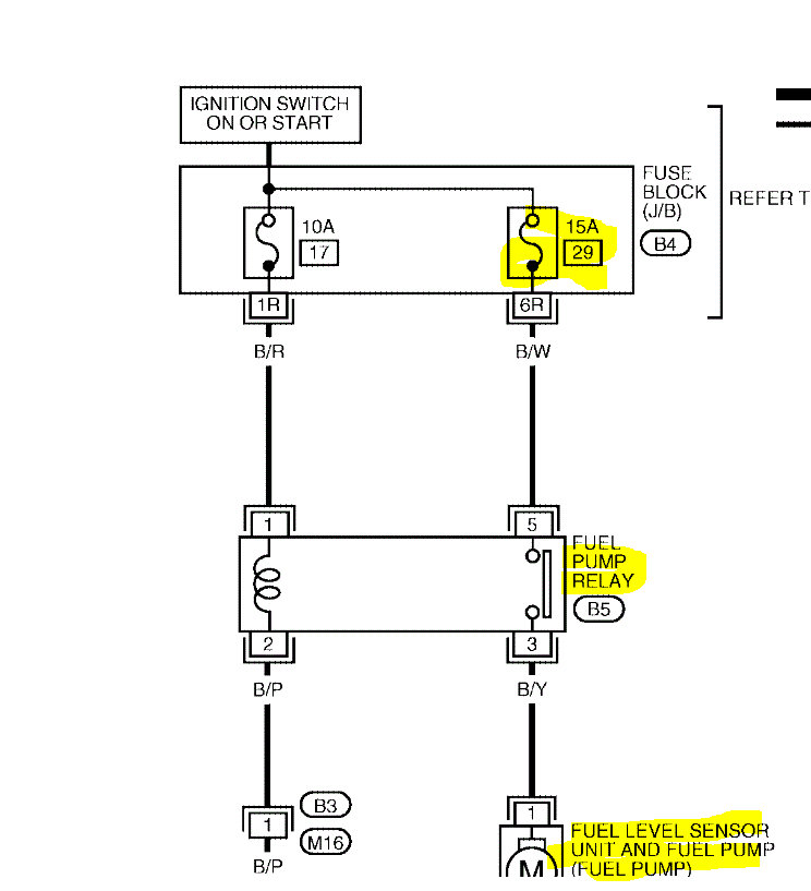

For some reason, I have pics of the fuse boxes, but no legend to tell me what each does. So, I had to look at a wiring schematic. I attached a pic below. In the under hood fuse box, check to see if fuse 29 is good. That is the fuel pump fuse. If it is, located the fuel pump relay and if there is another one with the same part number, switch them to see if that makes a difference.
Here is a link explaining how to check test a fuse and for power to the fuse:
If the fuses are good, see if the car starts for a couple seconds using starting fluid. If it starts and then stalls, we know it is a fuel related issue.
