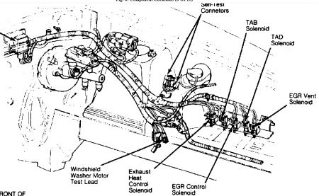

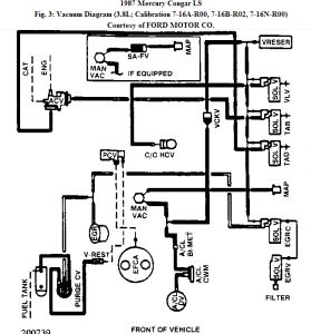

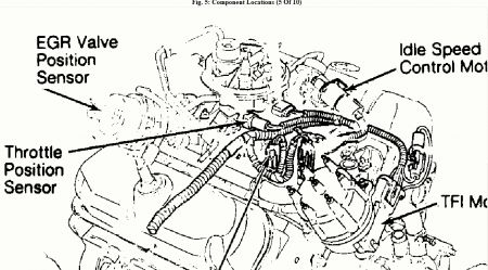

What is a exhaust control valve and how to hook it up what vaccum line?

Are we talking about the EGR? Exhaust gas recirculator? The valve is on the top of the engine and the EGR position sensor is on top of the EGR. Here is a few diagrams for you!
