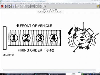

What is the firing order on a 1996 Mazda Protoge?
4 cyl. Engine.
Wednesday, November 14th, 2007 AT 12:35 PM
MERLIN2021
MECHANIC
17,250 POSTS
Distributor on right!
