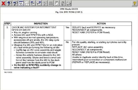

I have attached a diagnostic for the P1506 and it is self explanatory.
https://www.2carpros.com/forum/automotive_pictures/192750_P1506_96Mazda626a1_1.jpg
https://www.2carpros.com/forum/automotive_pictures/192750_P1506_96Mazda626a2_1.jpg
https://www.2carpros.com/forum/automotive_pictures/192750_P1506_96Mazda626a3_1.jpg
