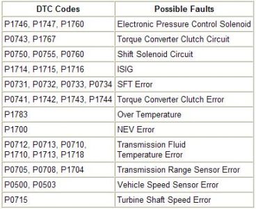

Probably about right for the shift solenoids. Check electrical connector at the transmission, make sure it's firmly seated, try disconnecting it, then inspect for corrosion, bent pins and do the same on the transmission, use a mirror to see the pins. Transmission codes are as follows and even a cheap hand held scanner can read them, I recommend you buy one, they work on all cars sold in the US since 96'
https://www.2carpros.com/forum/automotive_pictures/62217_Trans_Codes_1.jpg

Odd that you ask about the code readers. Mike, I asked about the pruchase of one, and was told it was not a good idea. It had caused people to install parts that were not needed because they read codes that were not it the proper sequences.
I don't do a lot of work, anymore, mainly because I don't have time or understand it as well in today's world. I also own a 2008 Lacrosse Special (love those V8 engines) a 2000 F-150 4X4, and a 1966 Volkswagen Beetle. Is there a particular brand or type of scanner that you would recommend? I just checked on this a few days ago, because of the Lincoln problem, and was talked out of it. Any help you could lend would help immensely. Do all of the reader plug in under the dash, or is there a computer just for the transmission? Thanks merlin, you have been a lot of help.
Saturday, July 31st, 2010 AT 2:13 PM
MERLIN2021
  • 17,250 POSTS
Depends how much you want to spend, a very good laptop program can be found at autoenginuity, or cheaper hand helds at any parts stores, you can always read your codes and post them here with make model and year engine size of the car and we can help from there. Transmission codes are read through the same connection.
