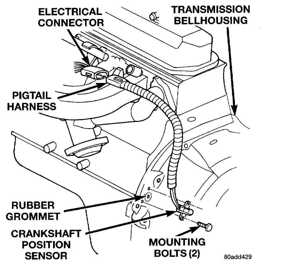

I got a new motor about 4 months ago, but the vehicle only ran for 9 weeks. One day I was driving, and it lost all power and shut off on me. I haven't been able to keep it on since it starts right away but if I start driving it loses power right away, I can't even go 20 feet. I bought a new battery in May. I also replaced the transmission solenoid sensor, got a new transmission filter, and replaced the fuel line. Someone keeps telling me it's the PCM that needs to be replaced but I'm not sure. I don't know what it is. I was hoping you could help me out.

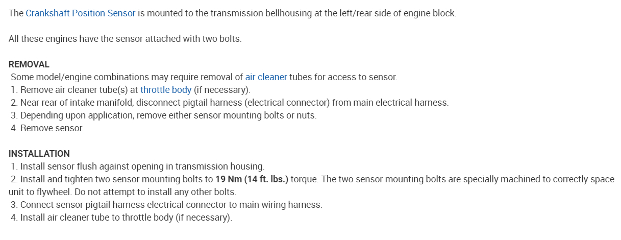

Sure, we can help, I would start with a CAN scan to see what comes up because it sounds like the crankshaft angle sensor could be bad. You can get a CAN scanner (Controller Area Network) which will work on most cars from Amazon.

Here is the location of the sensor in case you need it. Check out the images (below). Let us know what happens and please upload pictures or videos of the problem so we can see what's going on.
