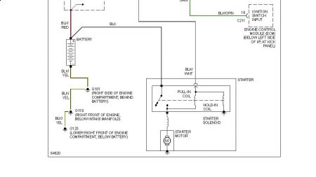

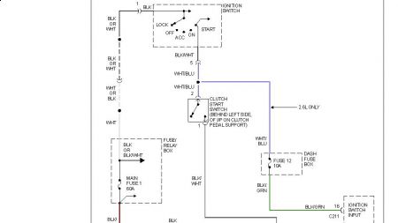

Will not start new starter and battery
Tuesday, January 26th, 2010 AT 4:34 PM
MECHANIC
75,992 POSTS
Sounds more like it won't crank over at all/nothing
Could be one of these fuse,starter relay, clutch switch and ignition switch
