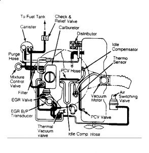

Some body crossed my vacuum hoses as a prank, I need a diagram for a 1987 isuzu pup 2.3 gas

Last question, what would cause one to flood after it gets up to running temp.

Check vehicle for any fault codes. You might have a faulty coolant sensor. Also check the rubber air intake boot for cracks.
