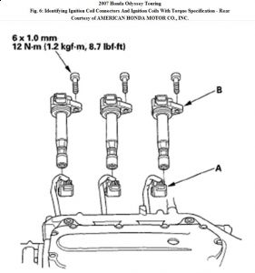

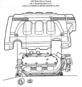

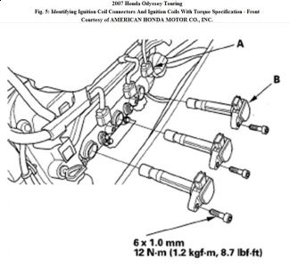

How do I access and replace the spark plugs and spark plug wires in my 2007 Honda Odyssey-Touring Model?

Hi smestel,
Remove the engine cover.
Disconnect the ignition coil connectors (A) and remove the ignition coils (B). Plugs can be removed.
