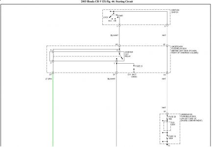

I have the starting schematics here.
https://www.2carpros.com/forum/automotive_pictures/192750_Starting03CRVFig44a_1.jpg
https://www.2carpros.com/forum/automotive_pictures/192750_Starting03CRVFig44b_1.jpg
From your descrpition of the symptoms, it seems the starter solenoid is not getting any power interminttently. The most likely cause would be the igntion switch or the starter relay. Try swapping the starter relay to see if the problem continues.

Hmmm, so I drove around again, and for a short time to my sons karate. The car didn't start after I turned it off, and normall when you put the key in the on position, (just before turning it all the way to crank it.)
I hear 2 clicks under the right dash area. Now when it didn't start, I didn't hear the 2 clicks. Does anyone know what part is under the dash near the glove compartment. Do you know where the starter relay is? Is this in the fuse box area in the engine compartment, or inside the cabin dash?

Underdash there are a few relays and one of it is the starter cut relay.
https://www.2carpros.com/forum/automotive_pictures/192750_FuseDash03CRV_1.jpg
Not hersing the click means the starter cut relay is not working due to lack of power supply. I would suspect a faulty ignition switch, could be only the starter circuit if the switch is faulty. The recall was for a faulty switch that can cause intermittent failing of the switch at the ON position.
