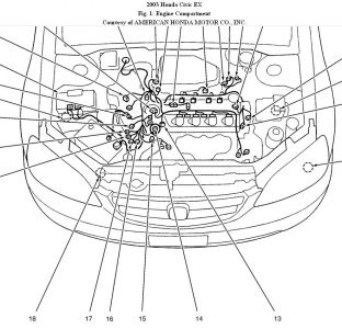

Where do I find the cooling fan switch? Any idea why is cooling fan not working? I just replaced my thermostat and still over heats.
Saturday, July 24th, 2010 AT 11:28 PM
KHLOW2008
MECHANIC
41,814 POSTS
Hi ces760,
The fan switch is located at rear right of engine. Item # 15 in diagram.
Did you test if the fans are working?
Do they come on when he A/C is turned on?
