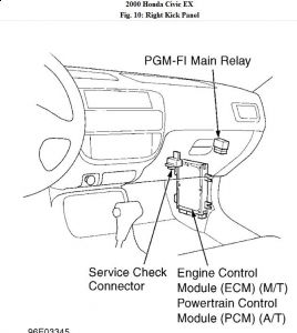

I have no idea where PCM is located though.
+1
Sunday, December 27th, 2009 AT 12:08 PM
KHLOW2008
  • 41,814 POSTS
PCM is located behind the right kick panel.
https://www.2carpros.com/forum/automotive_pictures/192750_ECMLocation00CivicFig10_1.jpg

Wow. Fast reply. Thanks you very much for that.I've also managed to download a service manual, maybe it will help me too. Couldn't find anything about my green key light flashing though in it.I will try to remove the pcm and dry it and see what happens. Will let you know. Thanks for the help so far though.
