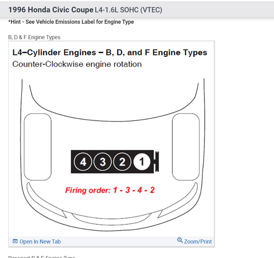

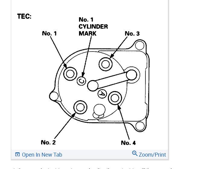

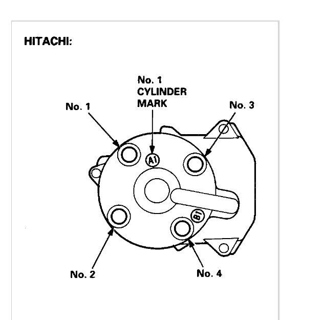

I got a 95 civic with a 96 civic ex engine in it. And I took off the wires from the distributor cap without marking them and I need to know the right order in which they go in?

96 honda civic 1.6 L MFI SOCH 4 cyl. Firing order: 1-3-4-2 distributor rotation : clockwise. Here are the plug wire locations and the firing order. #1 on the cap is below as well, there are two different distributor caps so take note of the cap difference to identify yours. Check out the images (Below). Please let us know if you need anything else to get the problem fixed.

Mathiaso is correct, but here is a picture to even further help you out!
