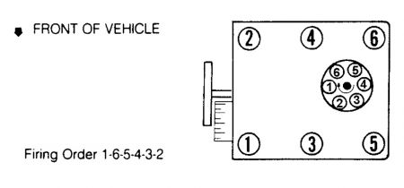

Do you have the firing order for a 1994 GMC V6 4.0L?
Saturday, October 9th, 2010 AT 7:04 PM
2 Replies
JDL
MECHANIC
16,098 POSTS
This firing order is for 94 gmc 4.3L engine.
