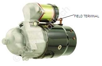

What do I use to check the voltage? And yes when the lights are on and I go to crank it, the lights don't dim. Are there any pictures I could see to help me?

https://www.2carpros.com/forum/automotive_pictures/170934_field_terminal_1.jpg
The picture will give general idea, different manufacturers may use a cable instead of a brass arm. It doesn't matter, they do the same thing, it attaches to the lower part of solenoid and goes into starter housing, like the picture. Use a testlite to check for voltage, they don't cost much at the discount autostores.
