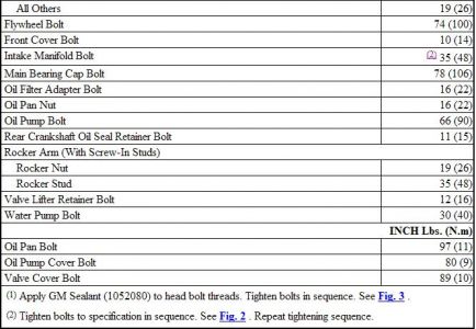

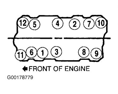

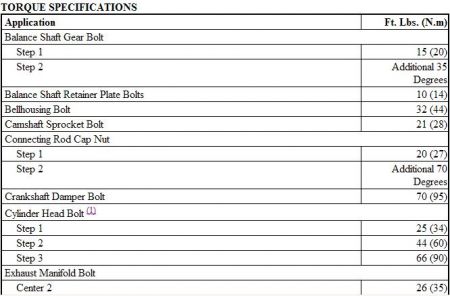

I NEED THE TORQUE SETINGS

FIG. 3
FIG. 2
