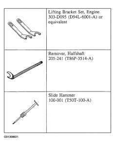

Install the special tool.
Install the special tools.

Using the special tools, remove the LH halfshaft from the transaxle and position out of the way.
NOTE:The use of mechanic's wire will aid in positioning the halfshafts out of the way.
Using the special tools, remove the RH halfshaft from the transaxle and position out of the way.

https://www.2carpros.com/forum/automotive_pictures/266999_tools_1.jpg
https://www.2carpros.com/forum/automotive_pictures/266999_tools2_1.jpg
https://www.2carpros.com/forum/automotive_pictures/266999_tools3_1.jpg
