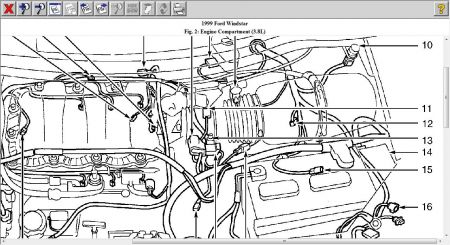

My engine temperature is getting hot, that is what my gauges is saying. I have plenty of coolant, and aux fans are working, and doesn't fell like my thermostat is sticking my heater is working fine.
My question: Where is my engine temperature sensor? I have looked for it and unable to find it.

What engine 3.0L or 3.8L?

It is a 3.8 litre

The ECT sensor is located on no. 13 see below
https://www.2carpros.com/forum/automotive_pictures/12900_ect_6.jpg

Be careful you choose the correct sensor: There are two water temp sensors in this same area. One is for the car computer to determine correct running parameters. The other one is exclusively for the dash temp gauge.
The one for the gauge should have only one wire attached to it (Red/White-stripe)
The other is for the car computer, has 2 wires (Light-Green/Red Stripe, and Grey/Red Stripe)
The sending unit with the two wires attached controls the fans, which ultimately cools the engine.
To gain access, you'll need to remove the intake snorkel & possibly the throttle body. If your fans are cycling on/off during extended idle, then the 2-wire sensor is doing its job and the 1-wire sensor is not sending the correct signal to the dash gauge. Replace the 1-wire sensor.
On the other hand, if your fans are not cycling and the coolant starts to bubble and/or steam is escaping from the pressure relief on the radiator cap, stop engine immediately, let it cool off for an hour or so. Replace 2-wire sensor.

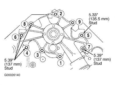

DAVE H
  • 13,383 POSTS
WATER PUMP
Removal
Disconnect negative battery cable. Drain cooling system. Remove accessory drive belt. Raise and support vehicle. Remove lower radiator hose. Remove nut on both front engine mounts. Lower vehicle. Remove generator. Disconnect power steering pump pressure hose. Remove cowl top vent panel. See COWL TOP VENT PANEL .
Disconnect water by-pass hose. Remove water pump outlet tube retaining bolt, and position tube assembly aside. Attach lifting equipment to left exhaust manifold. Raise engine approximately 5" (127 mm). Remove accessory belt pulley nut, and remove pulley. Remove generator support bracket.
Remove water pump pulley. Remove water pump bolts, nuts and studs, noting location of studs. Remove water pump, lower tube and gasket as an assembly.
Installation
Install gasket using Gasket & Trim Adhesive (D7AZ-19B508-B). To complete installation, reverse removal procedure. Lightly oil threads of bolt and stud not containing thread sealant.
If bolts originally contained thread sealant, clean and reapply thread sealant to bolts. Install studs into original location. Tighten bolts and nuts in sequence to specification. See Fig. 19 . See TORQUE SPECIFICATIONS . Fill cooling system.
Fig. 19: Water pump Bolt & Nut Tightening Sequence
Courtesy of FORD MOTOR CO.
https://www.2carpros.com/forum/automotive_pictures/266999_pump_1.jpg
