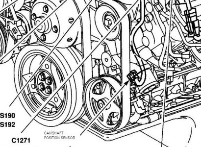

Where is the cam position sensor located on F550 with 6.0 L

Located left cylinder headjust below valve cover

driver-side, downlow, toward the front of engine. You could also check the wiring colors at the connector, compare to wiring diagram, to make sure.
