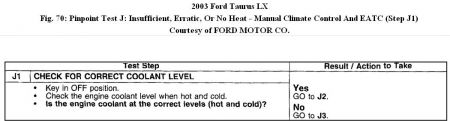

Fan works on all settings, but no heat when needed or A/C cooling.

Hi charlie. Mack,
Thank you for the donation.
Is your vehicle equipped with manual or automatic HVAC system?
Is the compressor engaging when A/C is turned ON?
Is the coolant level in radiator correct?
Was any repairs carried on the cooling system or the radiator coolant drained and replenished?
Problem could be due to a faulty air mix control system.

Manual controls, heat/AC control, compressor engages, occasonally. Coolant is at reccommended levels. Heat may come on 10 to 30 min into drive. No work on either system bought car used in 2005.

Perform the following test and see what you come up with.
http://www.2carpros.com/forum/automotive_pictures/192750_HVACTauraus03_1.jpg
http://www.2carpros.com/forum/automotive_pictures/192750_HVACTauraus03Fig70_1.jpg
http://www.2carpros.com/forum/automotive_pictures/192750_HVACTauraus03Fig71a_1.jpg
http://www.2carpros.com/forum/automotive_pictures/192750_HVACTauraus03Fig71b_1.jpg
