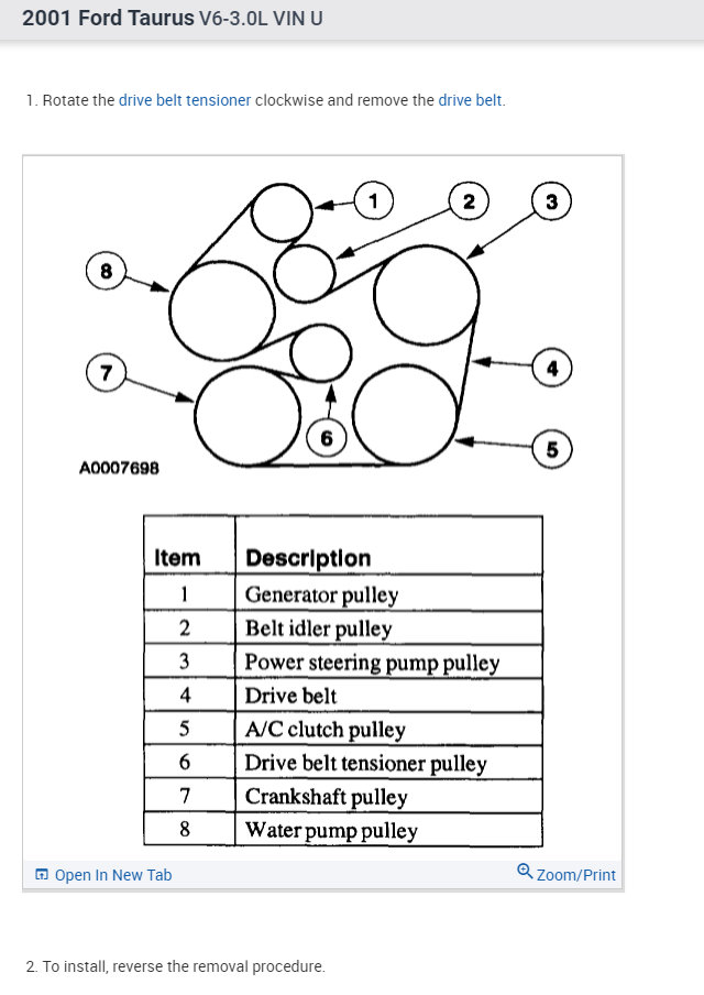

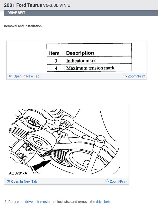

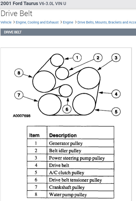

I bought a tool to help in moving the tension pulley but dont know how to use it it doesnt seem to move the pully at all no matter how much force I put on it due to other components seem to be in the way. Can you send a diagram on the propper way to do this? Thank you kent

Look's like you need a 1-1/4" open end wrench that belt bar won't work.Follow the instruction's i posted.

Take a look at this guide, it covers the belt replacement procedure including how to use the tensioner tool.
https://www.2carpros.com/articles/how-a-serpentine-belt-tensioner-works
I have attached the belt routing diagram and the replacement procedure below for your reference.
Note: Since the engine size/type was not selected I have provided instructions for the most common engine type 3.0L OHV. If it is a different engine, please let me know.
