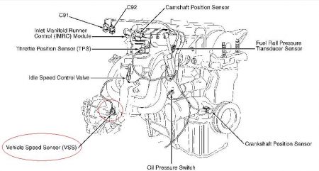

I have bought the new sensor but don't know where it is on the transmission.
Sunday, December 14th, 2008 AT 3:48 PM
BLUELIGHTNIN6
MECHANIC
16,542 POSTS
Location is on right side of transmission, near drive shaft flange.
