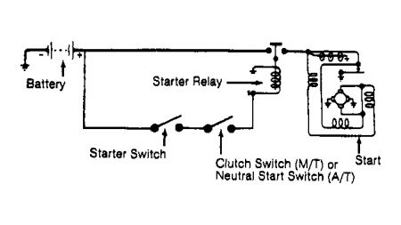

The Motorcraft positive engagement starter motor is used on all engines except the 4.0L and 7.3L Diesel. The starter system also includes a starter (ignition) switch, relay, neutral start switch (A/T) or clutch interlock switch (M/T), battery and heavy circuit wiring.
When the ignition switch is turned to the START position, the starter relay is actuated through the starter control circuit. This connects the starter motor to battery, permitting current to flow through the grounded field coil, actuating a movable pole shoe. See Fig. 1. The pole shoe forces the starter drive plunger lever to engage the starter and flywheel gears.
Check the Starter Relay

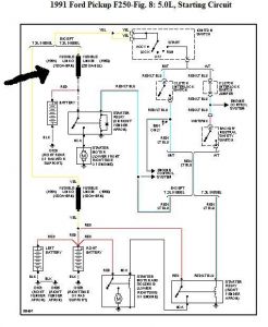

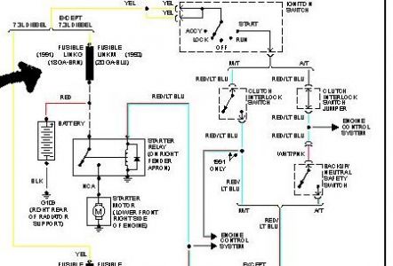

There is nothing AFTER the relay except the starter itself ..try checking the fusible link i have arrowed on the bottom diagram ?

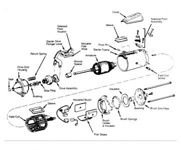

DESCRIPTION
When the ignition switch is turned to the START position, the starter relay is actuated through the starter control circuit. This connects the starter motor to battery, permitting current to flow through the grounded field coil, actuating a movable pole shoe. See Fig. 1 . The pole shoe forces the starter drive plunger lever to engage the starter and flywheel gears.

FYRBALL
  • 5 POSTS
So, thats good. Are you stumped yet?

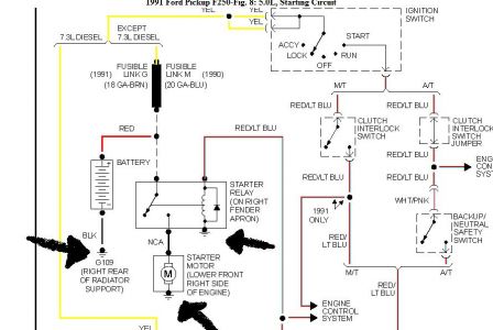

OK so you are getting power (hot)all the way through the system .. so we must have a bad ground ... we need to check ALL grounds I would start with the relay ground point on the fender wall ...then the starter ground.. see arrows on diagram .. let me know

FYRBALL
  • 5 POSTS
All look top notch to me.
Tuesday, January 20th, 2009 AT 1:14 PM
DAVE H
  • 13,383 POSTS
Even it they LOOK good. You will need to clean them off, to be sure of a good connection?
