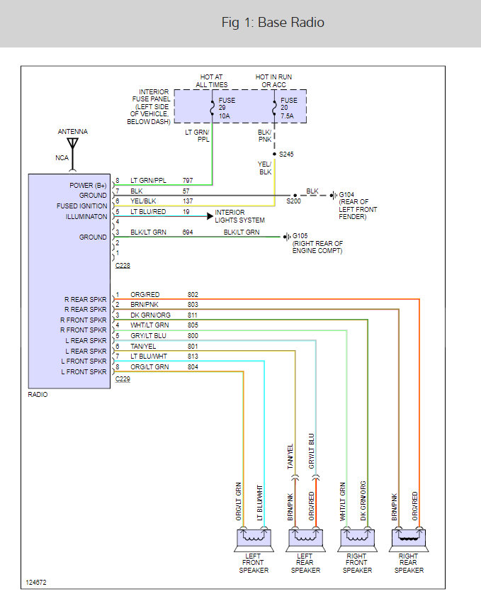

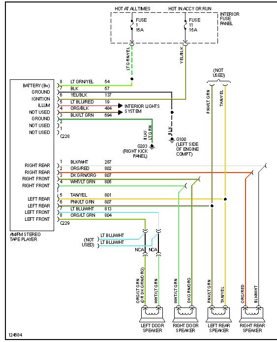

HMAC300
  • 48,601 POSTS
You will have to look and see where it was cut to begin with. This is for a base radio. Check out the diagrams (Below). Please let us know if you need anything else to get the problem fixed.
Monday, January 6th, 2020 AT 6:20 PM (Merged)

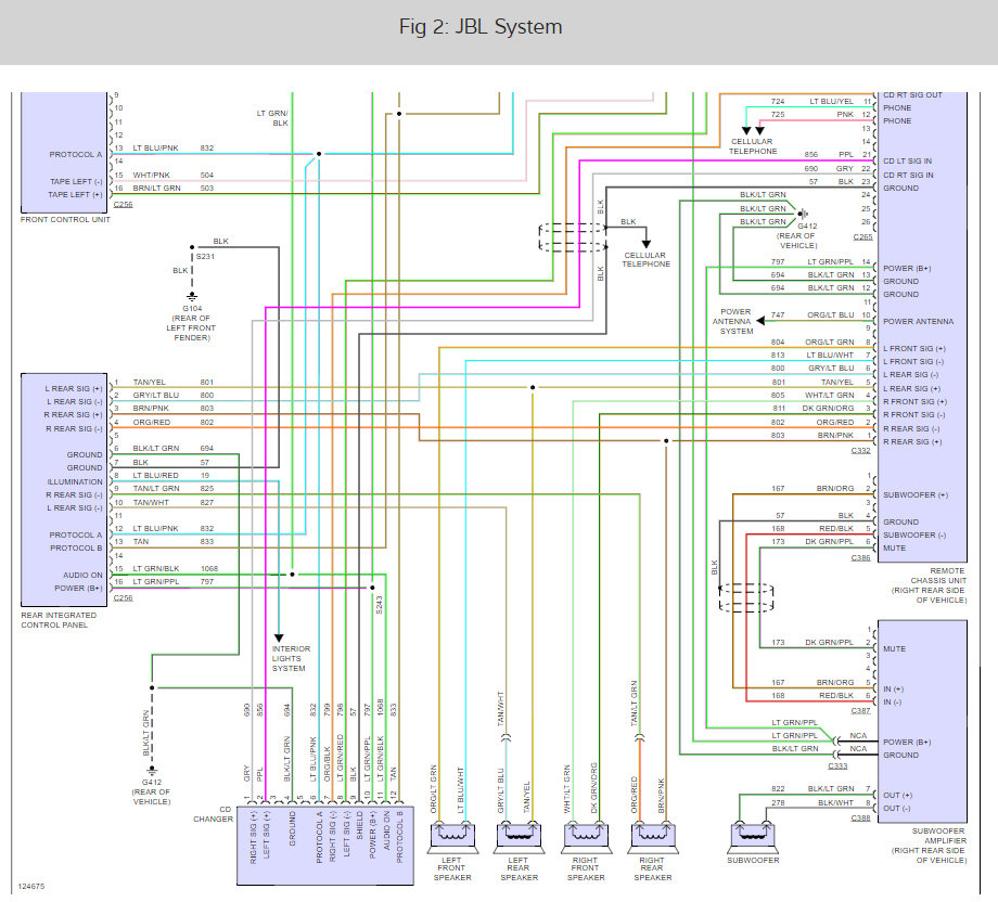

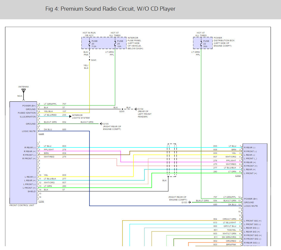

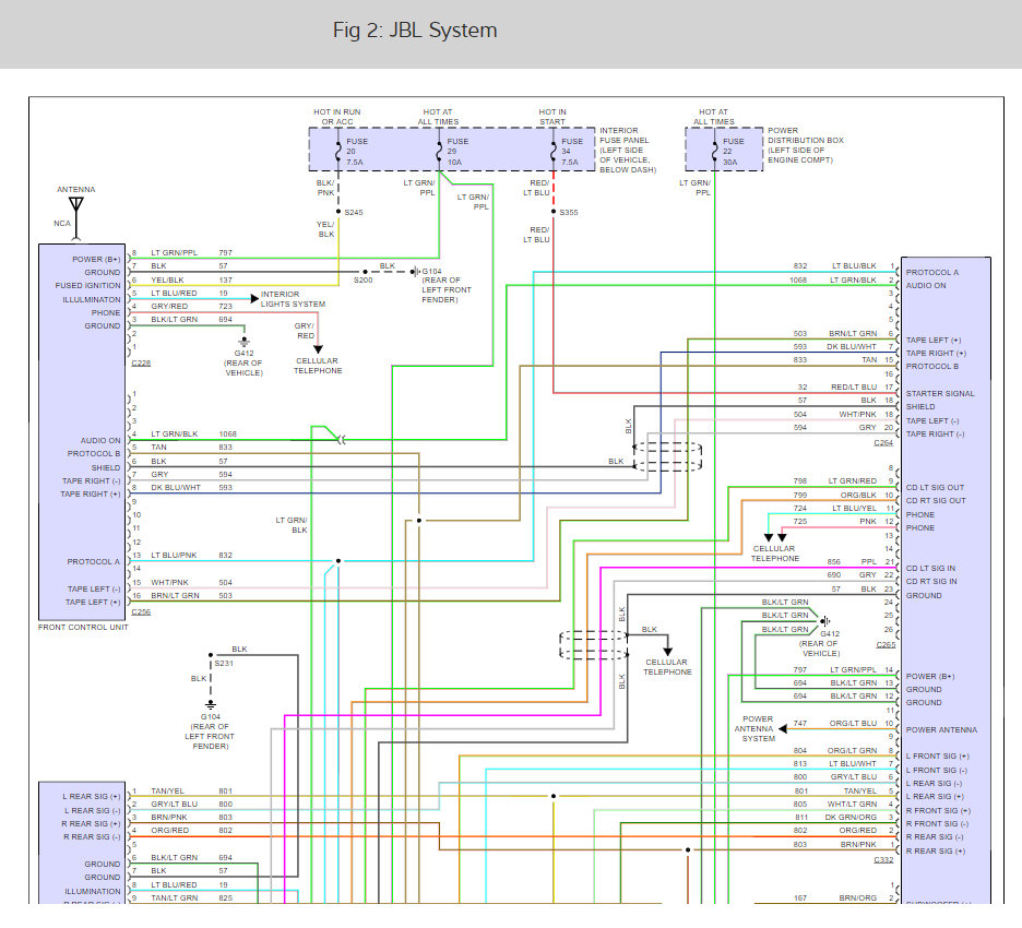

Normally you can buy adapters so it's just plug and play. There are 4 different radios for that year which one do you have? Base, jbl, premium w/cd or without
+2

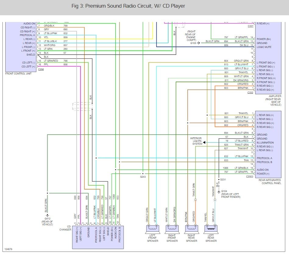

I need wiring diagram for Kenwood CD player I am installing.
Monday, January 6th, 2020 AT 6:21 PM (Merged)
KEN L
  • MASTER CERTIFIED MECHANIC
  • 43,416 POSTS
Here is a wiring diagram (below) for the radio and the CD player so you can get the job done.
+1

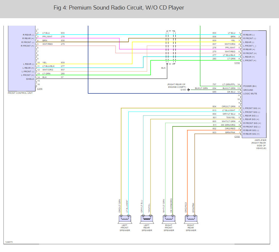

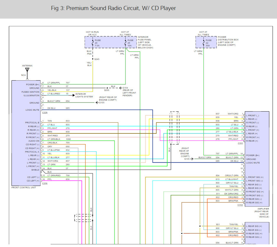

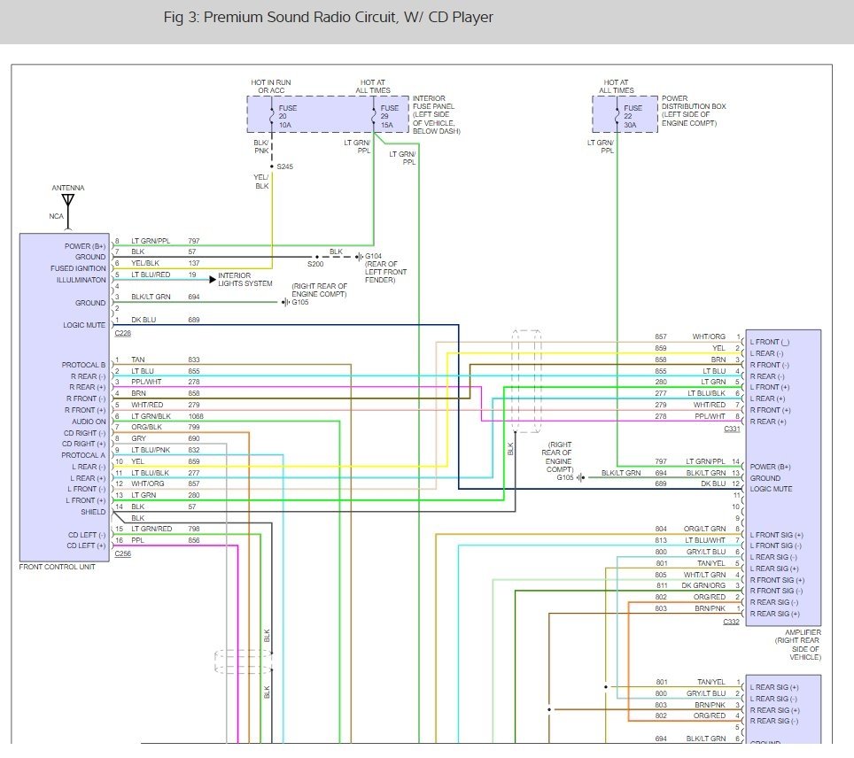

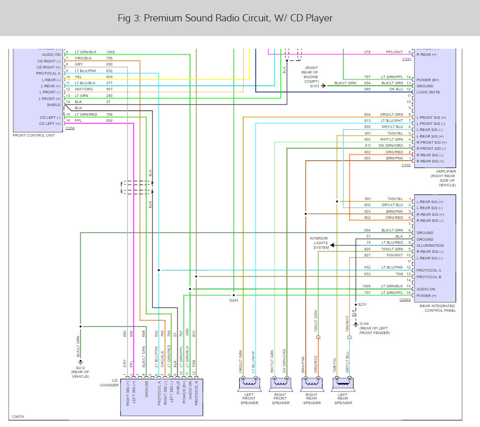

FORREST GILL
Ken L! Thank you so much for the wiring diagram * Fig 3. Premium Sound Radio Circuit w/ CD Player! Totally saved me on installing a double din apple carplay stereo in my 1996 Ford Explorer in which someone else had cut the factory wiring harness and added an amplifier at some point and just left a wiring mess to deal with. I kept getting the wrong wiring diagram until I saw what you had posted, and it matched my wire colors! Thanks! :)
Thursday, March 24th, 2022 AT 4:00 PM
KEN L
  • 43,416 POSTS
Glad you could get it fixed, that kind of problem can be tough. Please use 2CarPros anytime we are here to help.
