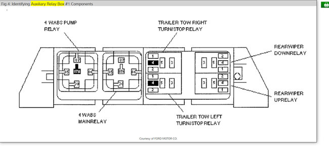

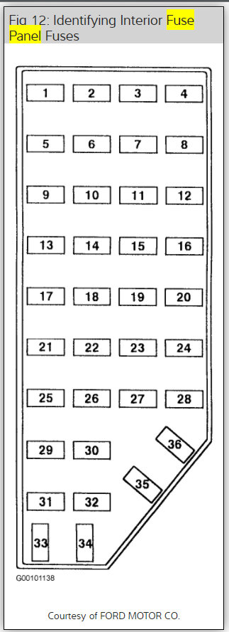

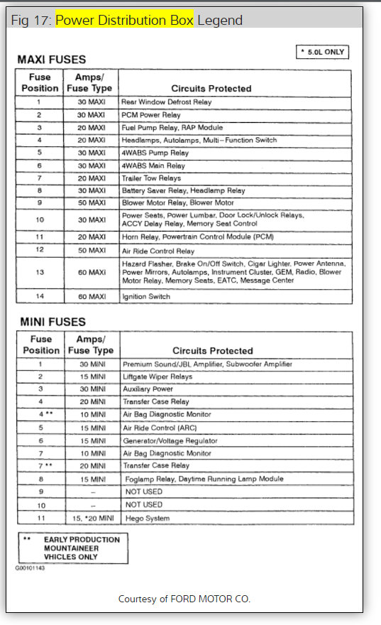

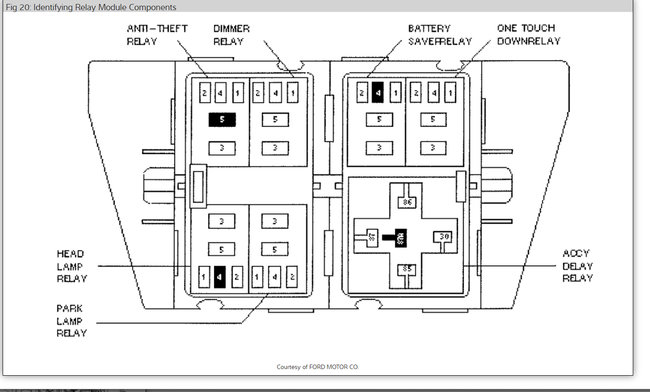

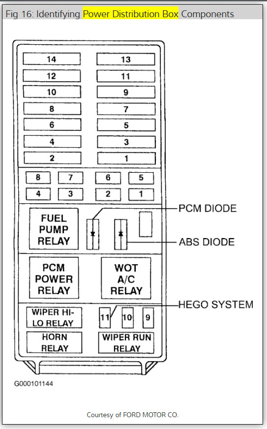

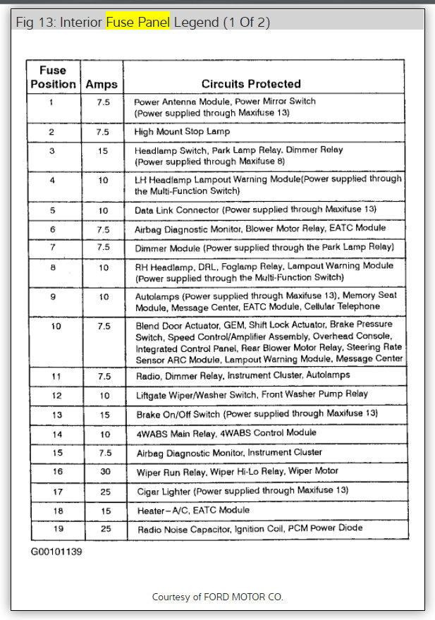

Hey MOESHA70,

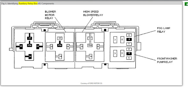

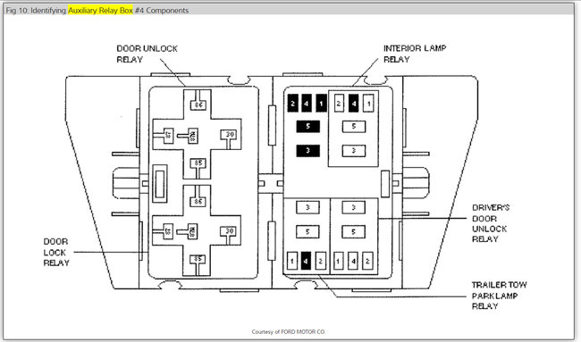

Here are diagrams (BELOW) for both the inside and under hood fuse box panels and relay locations. Here is a guide to help you test the fuses. Check the fuse locations in the diagrams below.

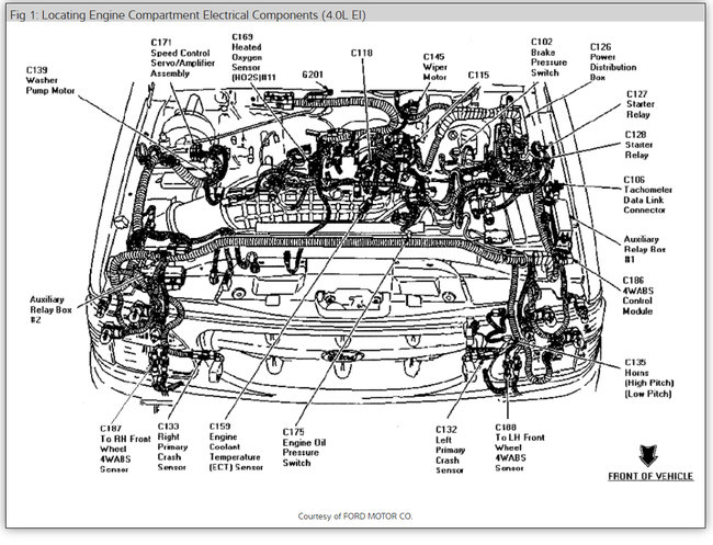

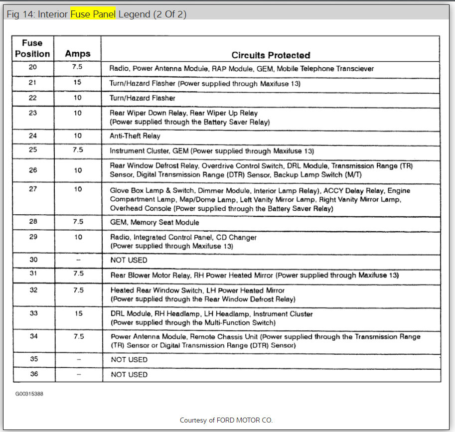

Here is a guide to help you test the fuse when you find it.
Large diagrams BELOW
https://www.2carpros.com/forum/automotive_pictures/266999_GraphicCA3IXJEQ_1.jpg
Below are the full size fuse and relay diagrams for the whole car, you should save this in your favorites for future reference as well.

The high mount stoplamp has fuse #2 in interior fusebox rear stoplamps use fuse # 13 in underhood fuse/relay box..
