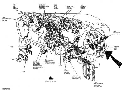

1996 FORD EXPLORER
Computer problem
1996 Ford Explorer 6 cyl Four Wheel Drive Automatic

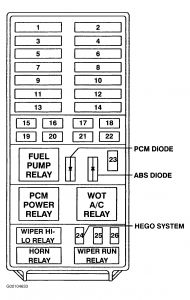

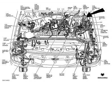

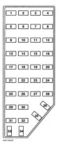

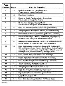

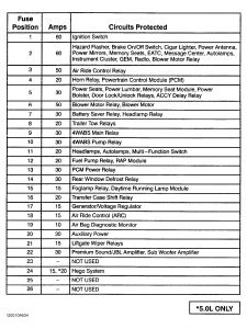

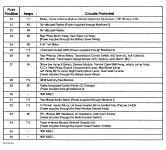

WERE IS THE FUSE BOX LOCATED.I DIDN'T GET THE MANUAL WITH THE TRUCK. THANKS FOR THE HELP
