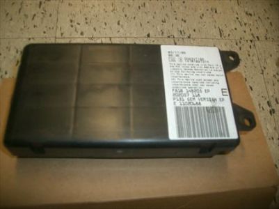

I think I know where the problem is coming from. A common problem with these vehicles is a water leak at the base of the windshield. Water leaks in (small amount) and leaks on to a part called the GEM, generic electronic module. It is located behind the fuse panel under the dash. Check for evidence of water getting to it.
Let me know what you find.

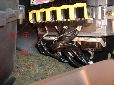

Pretty difficult to get behind the fuse box since I do not know how to remove it But everything around it, above it, and off to the sides, is Bone Dry. If I need to remove the fuse Box and look behind then just give a little advice on how and I will? Also not sure what is supposed to look like? Cannot seem to find any good pictures of one.

I understand. It is tight. Use a mirror to look up at it. Here are pictures. One is out of the car, and the other is still in the vehicle.
