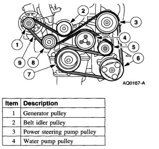

2003 Ford Escort need drive belt diagram
CORNELL2
MEMBER
2003 FORD ESCORT
Steering problem
2003 Ford Escort 4 cyl Two Wheel Drive Automatic
no digram in car any where
Thursday, December 10th, 2009 AT 9:50 PM
3 Replies
MECHANIC
75,992 POSTS
See below

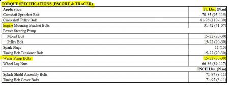

What are the torque specs for coolant pump, timing belt tensioner pulley, oil pan bolts and also the torque converter bolts?
Tuesday, July 9th, 2019 AT 9:35 AM (Merged)
BMRFIXIT
MECHANIC
19,053 POSTS
https://www.2carpros.com/diagrams/ford/escort/2002
