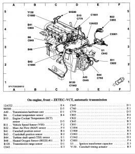

We have a 2000 ford contour that needs its speed sensor replaced. We already have the part to replace it, we just need to find where it is located.

Hi Calvin Ragsdale,Welcome to 2carpros and TY for the donation.
Vehicle speed sensor location see diagram below:
