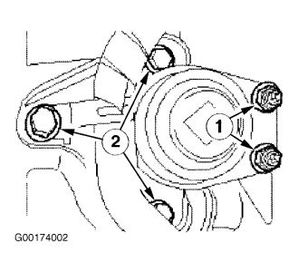

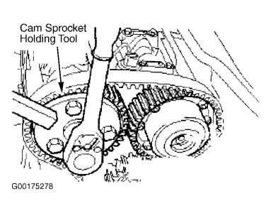

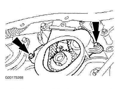

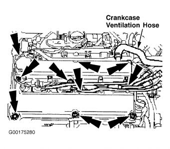

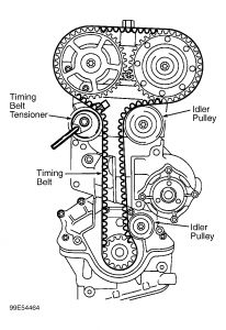

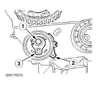

whats the Timing Belt proceedures on a 98 Ford Contour 2.0L can anybody help me?

Hope this helps. Let me know if ya need any diagrams?

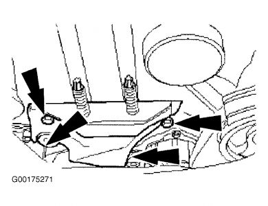

Remove lower timing belt cover. See Fig. 2. Working from under vehicle, loosen center bolt of left-hand and right-hand engine support insulators 2 turns. DO NOT remove center bolts.

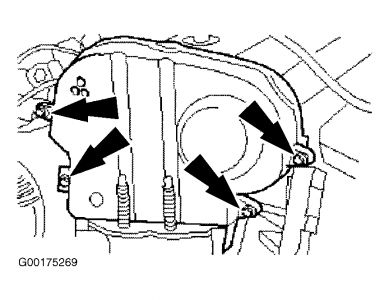

Remove power steering pressure hose bracket from engine lifting eye, and position aside. Remove the timing belt upper cover bolts, but leave the timing belt cover in its installed position. See Fig. 4. Remove the timing belt center cover/front engine mounting bracket. See Fig. 5. Remove the timing belt upper and center covers.

Remove blanking plug (1) from center of exhaust camshaft pulley. See Fig. 9. Loosen, but do not remove, exhaust camshaft sprocket bolt (2). Loosen, but do not remove, intake camshaft sprocket bolt (3). Remove timing belt.

Fig. 2: Identifying Lower Front Timing Cover Bolts
Courtesy of FORD MOTOR CO.

Fig. 4: Locating Upper Front Timing Cover Bolts

Fig. 7: Locating Crankcase Ventilation Hose & Valve Cover Bolts

Fig. 9: Identifying Camshaft Sprocket Holding/Removing Tool

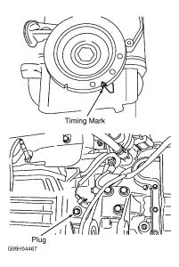

Rotate the crankshaft clockwise to TDC cylinder No. 1. Remove the blanking plug, completely screw in the Crankshaft TDC Timing Peg (303-574, T97-P6000-A), and auto-align the crankshaft to TDC. See Fig. 10.

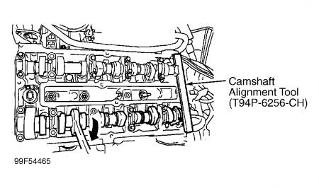

Hold camshafts with open end wrench. Turn the camshafts to ignition position on cylinder No. 4 and insert the Camshaft Alignment Plate (303-465, T94P-6256-CH) onto the ends of both camshafts. See Fig. 11.

Starting from the crankshaft timing belt pulley and working counterclockwise, position a NEW timing belt in place while keeping it under tension. See Fig. 12.

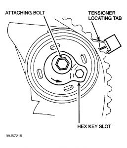

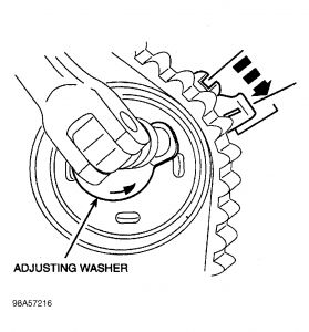

Apply tension to the timing belt. Incorrect timing belt tension will cause incorrect valve timing. Rotate the tensioner locating tab counterclockwise and insert the locating tab into the slot in the rear timing cover. See Fig. 13.
Position the hex key slot in the tensioner adjusting washer to the 4 o'clock position. Tighten the attaching bolt (3) enough to seat the tensioner firmly against the rear timing cover, but still allow the tensioner adjusting washer to be rotated using a 0.24" (6 mm) hex key.
Tension the timing belt, working counterclockwise. Using the hex key, rotate the adjusting washer counterclockwise until the notch in the pointer is centered over the index line on the locating tab (the pointer will move clockwise during adjustment). See Fig. 14.

Unscrew and remove crankshaft timing peg. Remove camshaft alignment plate from the camshafts. Turn the crankshaft 2 revolutions in the normal direction of rotation. Check the valve timing by inserting the crankshaft timing peg. Correct it if necessary.
Screw in crankshaft timing peg and make sure that the crankshaft is touching it. Insert camshaft alignment plate into the camshafts. If necessary, loosen the timing pulleys and correct the camshaft alignment. Remove the crankshaft timing peg and camshaft alignment plate. Screw in and tighten the blanking plug on the exhaust camshaft pulley.

Install the timing belt upper cover. See Fig. 4. Install the front engine mount. Connect the Power Assisted Steering (PAS) reservoir. Install the coolant expansion tank.

Hi Dave could you send me those diagram's for the procedures. Thanks

https://www.2carpros.com/forum/automotive_pictures/266999_con2_1.jpg
https://www.2carpros.com/forum/automotive_pictures/266999_con3_1.jpg
https://www.2carpros.com/forum/automotive_pictures/266999_con4_1.jpg
https://www.2carpros.com/forum/automotive_pictures/266999_con5_1.jpg
https://www.2carpros.com/forum/automotive_pictures/266999_con6_1.jpg
https://www.2carpros.com/forum/automotive_pictures/266999_con7_1.jpg

Did it run ok to start with after repair completed? I think you may have the timing out slightly. Possibly by one tooth on camshaft/crankshaft. The timing marks have to be spot on?
