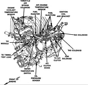

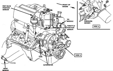

Where is the ignition module on a 1990 ford bronco 5.0?
Tuesday, January 12th, 2010 AT 1:38 AM
MECHANIC
75,992 POSTS
LH Side Of Engine.
RH Side Of Engine.
Top Front Of Engine
Applicable to: V8-302/5.0L & V8-351/5.8L Engines
